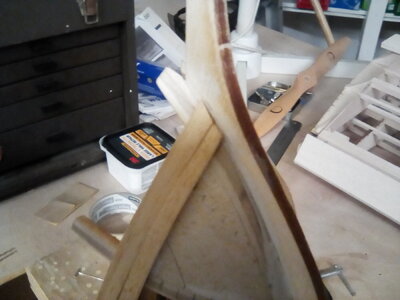

Watched a few videos on building....now using hot iron to bend planks...
I was soaking plank and clamping in place...steaming is quicker.
This model has no slot to put front of plank in and cutting planks to get nice curve at how a problem....any tips?

Hello Rcflyer! We suggest you open a build log (follow the link below). This is a very good way to interact with our members and ask for any help if required. To answer your question, many techniques can be used, and generally speaking, most of the kits coming without the marks for planking. Taper the planks toward the bow and stern- one of them!

In my experience the best “planking clamp“ is CA gel glue. Place a small drop of CA gel on the bulkhead point and hold the plank in place for 10 - 15 seconds. Otherwise there are a bunch of less than satisfactory options including pins, special clamps, mini nails, push pins, etc. For me none really stand out as best other than the direct CA gel glue.
