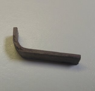

Help with bending walnut strips 7x3mm

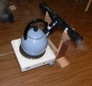

I use a steam box that I built myself with ordinary supplies available at any hardware store. A single burner hot plate, a steam kettle, and some PVC pipe and fittings. Steam is a reliable way of bending wood, just about any wood, I have even bent Ebony. Picture of the set up is attached. Give the steam time to soak into the wood fibers, each wood type will vary, from 10 min. to an hour.

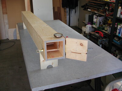

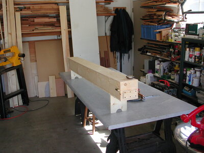

I built a steam box for bending strips of wood for fly fishing hand nets. Made of pine, it's 6 feet long. Steam is created by a steam generator designed just for this purpose. I think you would want a smaller version though. I can answer any questions you might have.
Bob
Thanks for the pic, nice little setup, so to confirm it's a normal kettle filled with water and you let it boil away as long as needed while making sure not to boil dry, does the PVC pipe have a vent hole to ease pressure and do you soak the wood first. Quite a wide time range so expect it would be some trial and error for correct timings, do you know it's right when the wood should bend fairly easy.
I built a steam box for bending strips of wood for fly fishing hand nets. Made of pine, it's 6 feet long. Steam is created by a steam generator designed just for this purpose. I think you would want a smaller version though. I can answer any quedtions you might have.
Thanks, it looks great.
The end caps are perforated so pressure can't build up and explode, and no, I don't soak the wood first, I let the steam do the work. I do keep a close eye on water levels so the pot doesn't run dry. It is a trial and error process to see how long certain woods and thicknesses take to become bendable. I hope this helps.

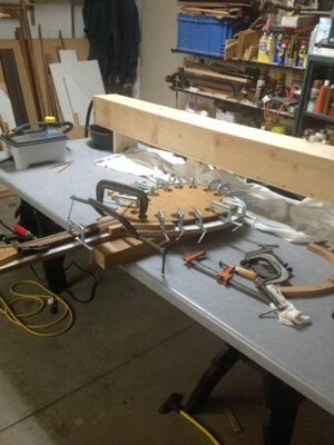

Don't forget when removing the steamed wood, they need to be clamped in a form or installed then allowed to fully dry.

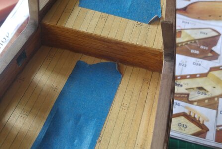

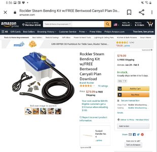

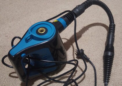

I usually let the wood soak in water for a couple of hours, and then use a steam cleaner (looks like this) to heat the wood. If you make a template of the corner that you need to bend, then you can use that to bend the (heated) strip around. It also easy to reheat the strip a bit with the steam cleaner. Looking at the picture, it seems like a difficult bend to make, but not impossible. And the other suggestions above are also good ideas! Have fun!
The Admiral has just brought the one in the picture which looks similar to yours for another purpose, I think the Deckhand could also put it to good use with your instructions, lets see what I can do over the weekend.
