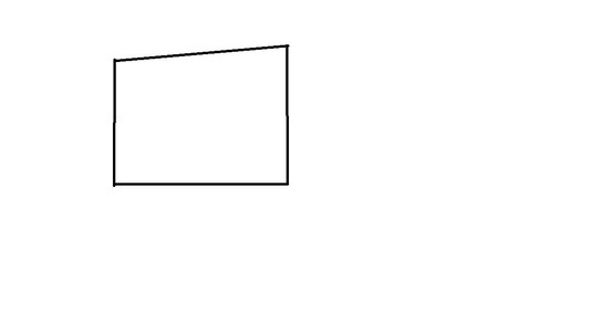

I have a little problem with making straight plank.This is what I get from Proxxon FET.
As you can see it's not a square. In previous parts on my build I managed to get past that, but now I need a perfect square

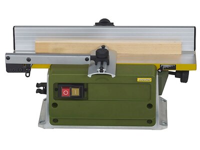

DH40

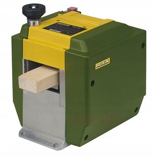

AH80
Proxxon FET saw blade inclination is adjustable. Take a straight 90 degree angle, adjust the blade for getting perfectly rectangular planks. Also when sawing ensure both front and rear ens of working piece are firmly pressed down to base while being moved through the rotating blade.

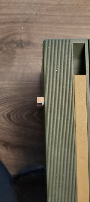

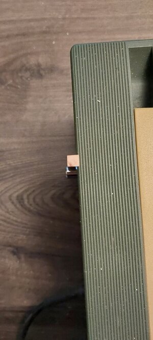

It's hard to show the difference on small pieces, but on larger ones it's significant
Before
Now
