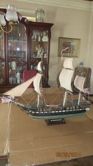

I did a full sail set on my Billings kit Bounty in the early 80s. The kit included a sail set that required sewing seam lines and details, etc. Another detail was sewing on a rope around the edges of the sail. Anyway, what I ended up with after all the sewing was a stiffened sail that was easily shaped to look like they received a light breeze. The running rigging for mounting the sails helped keep the slightly bellowed shape of the sail. All of this to say that adding the sewn details allowed the sails to be shaped nicely and the running rigging for mounting the sails held the shape in place. Another option to consider…
