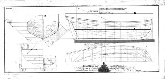

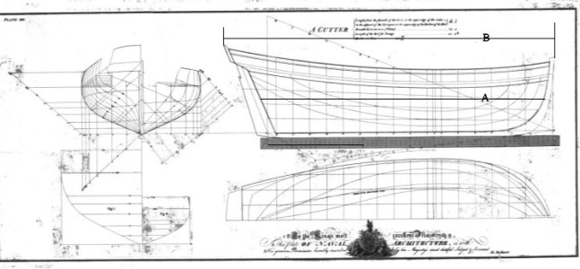

Quick question Is this 60ft?RG19_ALPHA_Ship-0.1_09.jpg It came out low quality but It says 60.0 on the top next to the text.
838.75 Hard to understand the words from where they are measuring. 60 feet is shown on line A that I have added. Overall length is 838.75 inches. (Line B) This is assuming the overall print is not stretched or shrunk or otherwise degraded. I inserted the print into CAD and took it full scale using the rule under the keel.
Hope this helps. Do you know the source of this drawing? It may be easier to get clearer information if you know who holds the original.

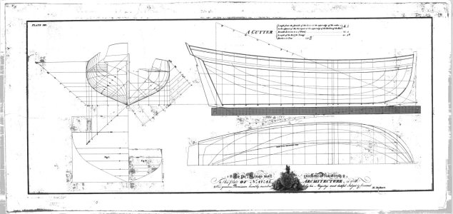

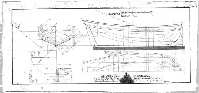

I edited the drawing to be grayscale when printed. this is the site where I got if from is :https://www.model-monkey.com/product-page/royal-navy-cutter-1781
for some reason the quality lowered when I posted it hear.
Note: I don't know if attaching files makes the files accessible in the original size to others but I added both the original and the edited version
My guess for the source is a plate in:
NAVAL ARCHITECTURE 1787 2ND ED 2 VOLUMES
STALKARTT,MARMADUKE
It may or may not be the plan of an actual vessel.
I do not think that either A or B would match the 60 ft description.
The thicker lowest black line at the wale. Where it hits the thick black line at the wing transom aft and the aft edge of the stem rabbet. A perpendicular line at each point AP aft FP fore. Use that for the 60 ft.

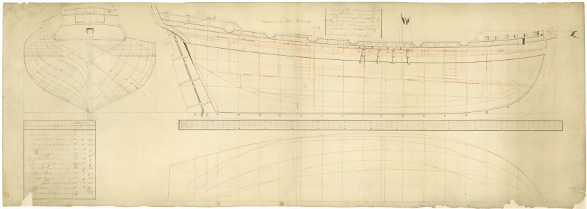

This makes sense because this cutter has a lot in comin with HMS Alert which was about 90ft. But maybe that's just because there both British cutters.
Thanks for the help -DAWarden-(Jaager) & AllanKP69.
Hears a comparison of the two :
RG19_ALPHA_Ship-0.1_09 (1).jpg​
↓ HMS Alert
OK, forget about the 60ft. We naval architects are like lawyers. If we didn’t confuse things everyone would know what we are doing! As a result there are several definitions of Length.
On the other hand, the word Beam is well defined. It refers to the vessel’s maximum breadth, easily measured on your drawing. If I am reading the small sized drawing correctly the extreme breadth is also listed there. The ratio between the measured breadth and that listed on the drawing is the scale.
Roger
My bad for causing confusion. Neither line that I drew was meant to match the description, I was just showing you the actual dimensions at those points as examples. The drawing is full size, 1 to 1 scale, and dimensions/lines I show are actual at those points.
Great point Roger, thanks. The plan matches the legend, 25' 4"
"C" below
I do not know the real or actual of what is Breadth. I have read that there are two different measurements and uses.
The version that I work from is:
The LxBxD number for breadth is extreme Breadth
extreme breadth includes the thickness of the bottom planking and that number is used to calculate tonnage? or some reflection of the volume of the hull.
On design plans the Body plan is the breadth at the inside of any planking.
To make it even more ambiguous, the breadth is usually where is the wale. The wale is thicker than the bottom plank.
I got AP and FP from Deane's Doctrine. They are his key design beginning points.

Breadth is it. If the official breadth also includes the width of the planking then using it as the value for the X line on the Body plan will produce a scale correction factor that is a percent or four too large.
If the the thickness of the bottom planking x2 is subtracted from the Official Breadth, it helps to know just how thick is the bottom planking.
