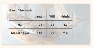

Size of the model in scale 1:48

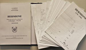

Thirty-four plates, most of them with comments, provide a detailed picture of the ship.
left the booklet and on the right the huge number of drawings

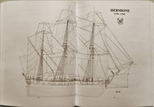

Final Comment:
Not much to say, only - a wonderful complete planset and monographie of a technically and historical very interesting frigate.
As usual from the ancre publications - Highly recommended

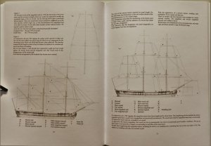

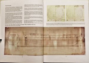

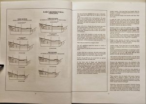

LOOK INSIDE of the BOOKLET

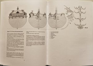

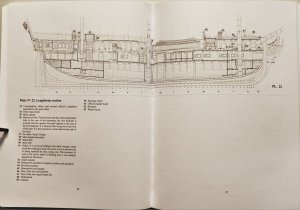

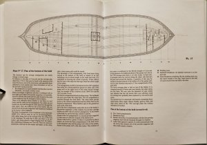

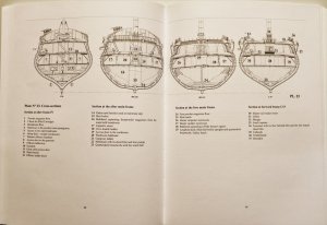

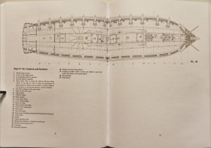

Explanations and Comments to the plates
In the following post you can find the LOOK INSIDE of the drawing set ........ to be continued ......

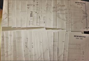

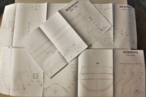

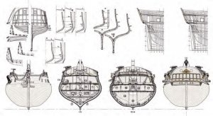

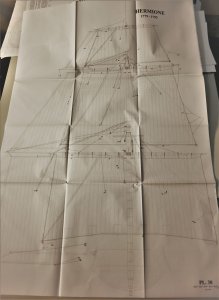

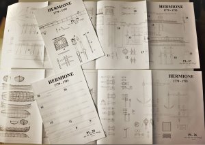

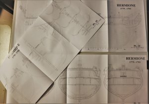

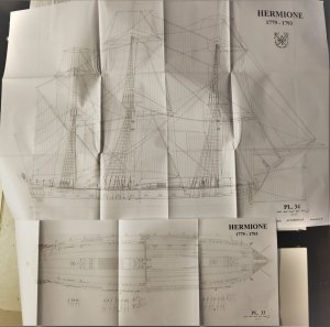

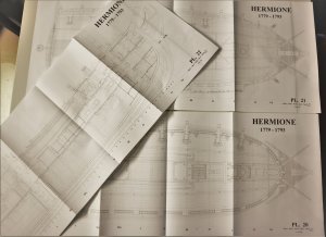

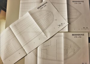

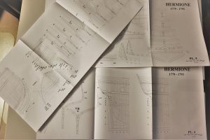

LOOK INSIDE of the DRAWINGS

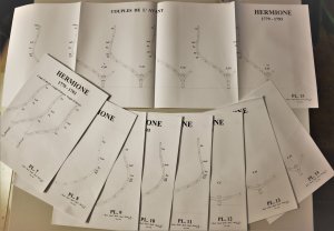

all drawings in the overview - a lot of paper !

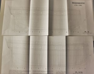

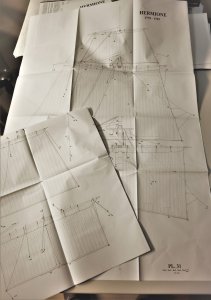

The frames - for each single frame you have a designed special drawing

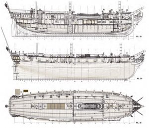

Each mast is shown complete with all rigging
Final sail plan with complete belaying points deck plan
You see - nothing missing to prepare a complete wonderful model - Highly recommended planset!

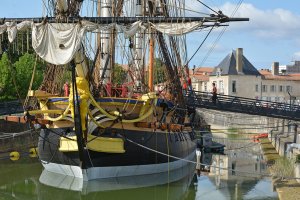

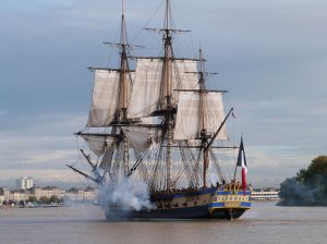

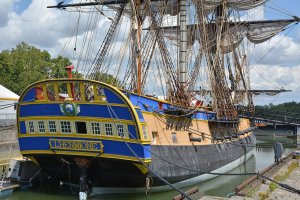

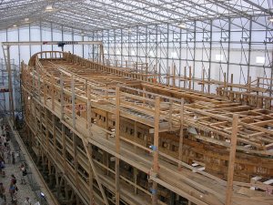

And finally the replica of the Hermione
The Hermione is a 32-gun Concorde-class frigate fitted for 12-pounder guns, completed in Rochefort by the Asselin organisation in 2014. She is a reproduction of the 1779 Hermione, which achieved fame by ferrying General La Fayette to the United States in 1780 to allow him to rejoin the American side in the American Revolutionary War.
Construction
This project was conceived by members of the Centre International de la Mer in 1992, and construction began in 1997, envisaging a launch in April 2015 (as compared to the original, which took less than a year to build).
The shipyard was in one of the two dry docks beside the Corderie Royale at Rochefort.
As far as possible, traditional construction methods were used although modern power tools were substituted for the period tools on some jobs. The site is open to the public, and admission fees help fund the project.
English plans of a sister ship, Concorde, were used. The cost was estimated to be $22 million. The original plans had been modified in several ways for reasons of strength and safety: planks had been bolted rather than pegged to avoid movement during the long period of construction. Similarly, the mast sections were fastened with glue rather than metal hoops to avoid water penetration. The cannons are lightweight and non-functional to save weight, and for legal and safety reasons. Hemp rigging was used, and the sails made of linen.
An engine will be used for safety, and electric generators for lighting and basic amenities.

An initial chapter is concerned with the nautical qualities that warships must have possessed. They were especially mediocre for vessels built during the 17th century and the fi rst half of the 18th because of the use of obsolete concepts. The new design concepts that were adopted toward the end of that period are described next, as well as the improvements in performance and sea-going capabilities that resulted.
A second chapter is the object of a detailed study of documents concerned with the architecture and characteristics of sister-frigates, a study that allows the identifi cation in a plausible manner, of the various poorly known aspects of Hermione.

CONTENT of the DRAWINGS
1. Schematic elevation
2. Schematic plan view
3. Vertical view of frames
4. Construction of the stern
5. Construction of the stern-frame
6. Construction of the hawse pieces I
7. Construction of the hawse pieces II
8. Profiles of aft frames 1 to 6
9. Profiles of aft frames 7 to 12
10. Profiles of aft frames 13 to 19
11. Profiles of aft frames 20 to 29
12. Profilles of the main frame and forward frames 1 to 5
13. Profiles of forward frames 6 to 11
14. Profiles of forward frames 12 to 18
15. Profiles of forward frames 19 to 24
16. Timbered elevation
17. Plan of the bottom of the hold
18. Between-decks plan
19. Timbering of the gundeck and castles
20. Gundeck and its furniture
21. Castles and their furniture
22. Lengthwise section
23. Cross-sections
24. Built-up elevation
25. Decoration of the stem and stern-frame
26. Artillery and furniture
27. Elements of furniture
28. Plans of masts and yards
29. Mast fi ttings
30. Mainmast masts and rigging
31. Foremast masts and rigging
32. Mizzen masts and rigging
33. Running rigging (1/72 scale)
34. Hermione under sail (1/72 scale)
View attachment 66991 View attachment 66992
View attachment 66993 View attachment 66994
View attachment 66995 View attachment 66996
View attachment 66997 View attachment 66998
View attachment 66999 View attachment 67000
View attachment 67002 View attachment 67003
View attachment 67004 View attachment 67005
View attachment 67006 View attachment 67007
