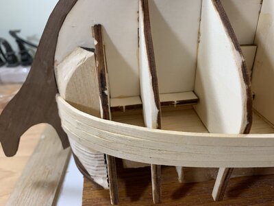

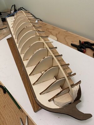

Working on the planking and finding it very difficult due to the thiknes of the planks .
Maybe you can show us with one or some photos where exactly you have problems, so we can try to give hints to make it easier (or better)
Will you start a building log of your Hermione build? -
I ask this because you posted this topic in the logs area - if not, no problem, we can easily move this topic to another area

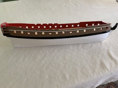

The instructions are picture only and very little information. The quality of the parts seem very good some of the planking is very thick and hard to work with but I managed OK. The rigging is going to be a real challenge because there’s very little information.
Thanks for your reply!
I see what you mean about plank thickness - probably to allow for lots of sanding (single plank kit).
Looks like this one is a bit "over my head" for now.
LOOKS GREAT!!
Please keep posting photo, etc of your progress! I'm looking forward to following your build!
