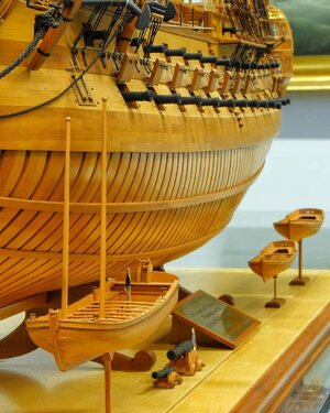

Historical relevance: heavy bolted vs flushed trunnels
Here is an old question in my head. Is it more of a stylistic personal artistic choice or is there historical relevance supporting these two choices?
Best regards

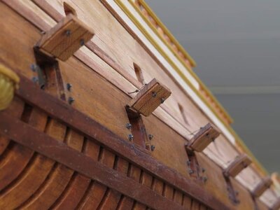

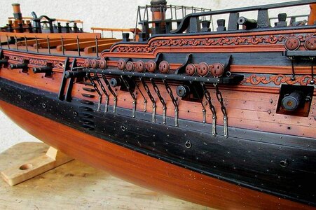

embossed bolts
Flushed bolts/trunnels

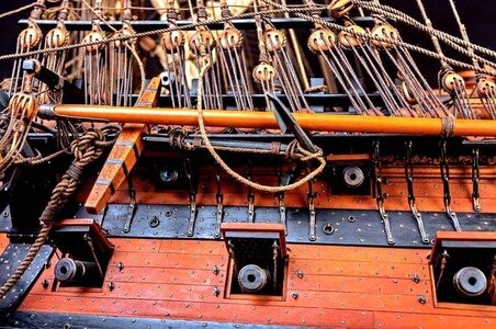

I think historical and technical correct are the visible boltsheads - most of them, f.e. these for fixing planks and wales against the framing were flush with the plank.
but others, especially these which have to take forces like gun tackling, knees etc had slightly elevated boltheads (washers etc.)

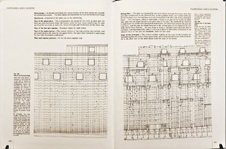

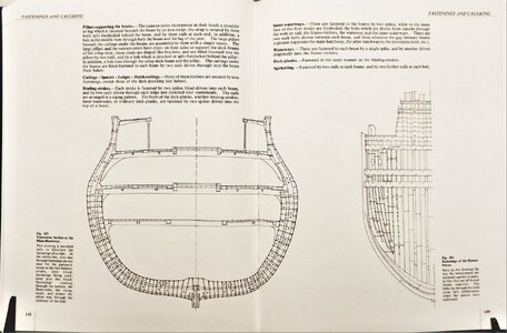

These are exerpts of Boudriots 74 gun ship showing the inner and outer hull with the number of bolts

i do like the look of heavy bolts though... nice detail.
