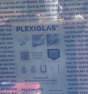

Glass has the green tint - not plexiglass.
Good morning Paul. I am clueless when it comes to these things. I made my Victory with proper glass and this was not the way to go. It is too heavy and very brittle. I found a small company in Cape Town which supplied “Plexiglass “. If it is proper Plexiglass or South African plexiglass ROTF I have no idea. Looks cool tho and is a good option for making cases. I know it is a form of Acrylic.
The label says Plexiglass so it must be Plexiglass ROTFROTF.
Cheers Grant
Cheers Grant
Plexiglas® is brandname specific to the company which invented it, Röhm GmbH and Arkema Inc. If your material is marked Plexiglas®, it is probably made by them.
