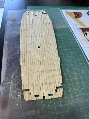

I've got the skeleton done and the main deck for now. Next will be the foredeck to try my hand at joggling the planks. I'm going to try to follow along the Anatomy of the Ship for details as much as my abilities will allow. See you in a few weeks!

After 4-1/2 months away, due to various illnesses for myself and my wife, getting back to it. First coast of stain to the main deck. This is after about 4 hours of drying. I used MinWax Weathered Oak #270. I was thinking that I was going to use a second coat of stain before varnishing but I think that it looks dark enough. I'm going to use the Occre satin varnish thinned to 5:1. It seemed awfully thick when I put a couple of drops out to test with it.

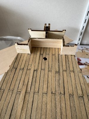

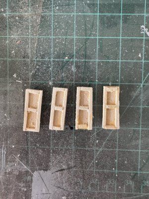

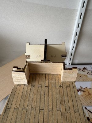

I've made some progress. I've built out the fore and aft cabins and have crafted the 4 doors for the aft. I noticed in Marquadt that the fore cabin has sliding doors into the sick bay and pit. I may try my hand at those as well. I still haven't figured out how I am going to finish the cabin walls. Perhaps a thinned sapele dye and then the doors painted brown? I dunno. Will have to play with colors.
Deck - 11A Fore Cabin Planked.JPEGDeck - 13 Aft Cabin Planked.JPEGDeck - 12A Cabin Doors.JPEG
Hi Crazy,
Great progress. Just a quick question; it looks like one of the planks is buckling slightly and you haven't sanded the deck (yet). I would try to remove that buckled plank and shorten it a bit, or replace it with a shorter one. In my opinion, this would make the deck look a bit cleaner, unless of course you did this intentionally. In any case, it's great that you are sharing your progress with us.
