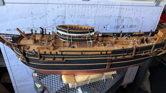

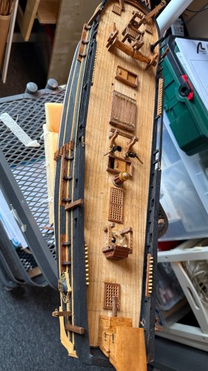

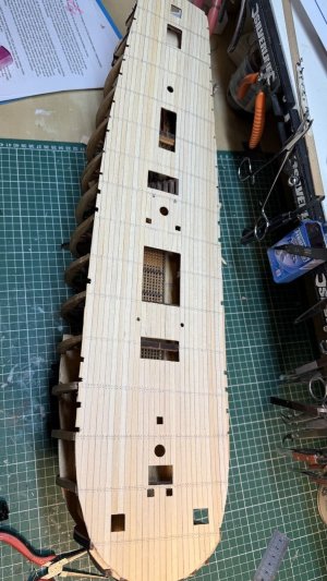

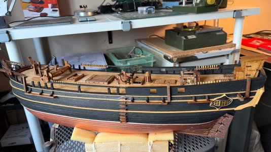

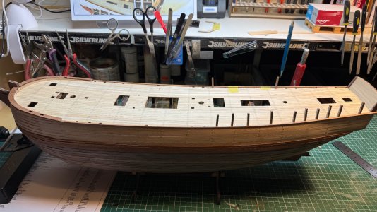

Great progress, Patrick!
I think the colour of the deck planking goes well with the rest of the hull. Well done!
I’d be careful about painting the masts and yards completely black, as your hull already has a lot of black on it.
I’m looking forward to seeing your work on the rigging!

Hoi Erik,
After some thinking... my idea too.
I've also think that painting everything black would be a bit too much... I'll definitely just varnish the masts.
To be continued..
Patrick

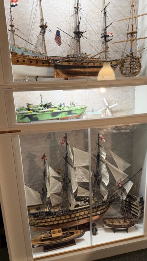

Thanks for the nice pictures, love the details.... I know these modelbuilding is not my league I justly to do my best :rolleyes: and enjoy my hobby...
Patrick
enjoy my hobby..
The models from RMG are far beyond what 99.99% of us do, but I bet we enjoy it as much or more as those teams of master builders did. It is my understanding that they were usually built by teams of artisans so at least we can say "I built this model" rather than "We each built some parts of this model"
I'm starting on the masts, I'm not sure what colors they will get... I think I'll follow photos where the yards are black, with white ends, the masts with black tops. (or totally black?)
The bowsprit and cap black.
The unpainted parts are varnished.

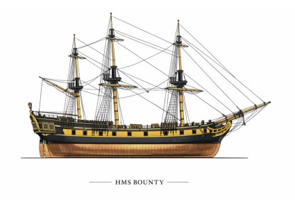

Dear Patrick, good afternoon! To get an idea of the paint schemes of English ships from the 1870s to 1790s, just look at the marine paintings of those years.
English ships in the 1780s had a standard paint scheme.
Red paint is iron minium, which protects wood and iron from seawater and also serves as a heat-resistant coating. Red iron minium was used to coat the structural elements of a ship's hull, the inside of its sides, gun ports, and gun mounts.
Black paint was made from carbon black. This paint was distinguished by its high wear resistance, making it the preferred paint for the lower hull and gunwale. It was also used to coat the tops of masts and topmasts.
White paint was made from lead white and was rarely used in the 1780s.
The primary paint used to coat the ship's hull and masts was dark yellow mineral ochre. This paint was not only durable but also provided excellent protection from seawater.
Yellow paint—usually a pale mineral ochre mixed with lead white. It was intended for painting decorative elements and sculptures. This paint was also used to imitate gold on figureheads.
The Bounty had a standard paint scheme for its hull and masts, exactly the same as in contemporary paintings.
