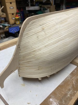

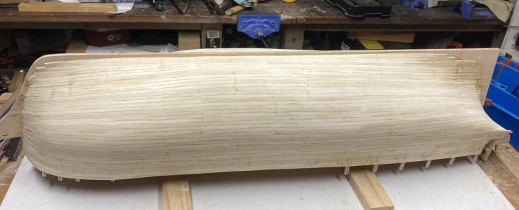

Here I am, first planking completed, just need to sand smooth and trim, no filling required.
I like the bow planking, worked well using the patterns and sticking to the plan all the way!
Now the second layers begins, but much easier, a better surface. Just need to scribe on the battens after cutting the gunports out.

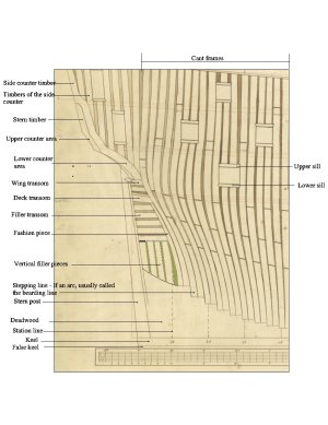

Sorry my wording confused you. For the first planking I glued battens across the hull to establish the plank true runs. For the second planking i will scribe (draw) the batten positions and not glue on an actual batten. I also have the outer planking plan from the Greenwich collection for reference.
