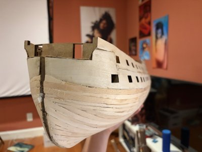

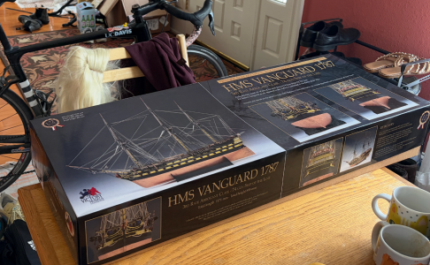

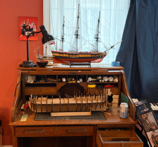

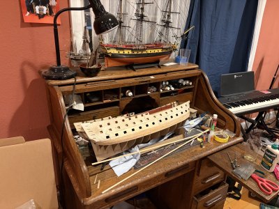

Hello all from California! My name is Jan. For my 26th birthday I bought the HMS Vanguard Amati 1787 kit off of Facebook Marketplace, having eyed it for several months. I didn't jump on it right away figuring the total market size of this hobby is very small and it wouldn't move quickly.
I have always loved ships of the Age of Sail and have dreamt of building a wooden ship, and so last year I finally took a giant leap and built the Mamoli HMY Mary to see if my patience had evolved to a level I could spend months on a single art project. My eventual goal was a ship of the line, so after that I built the Frigate Hermione (took ~10 months), and a Revell plastic Beagle kit.
This kit is a behemoth. The box weighs more than 30 pounds.
My plan is to build this kit as the HMS Elephant. I adore elephants, and shall try to build this ship so I can display her with an elephant figurehead and varnished wood sides. I don’t see many Elephant build logs on here, or on the internet in general. I trawled Instagram and found one public account with it.

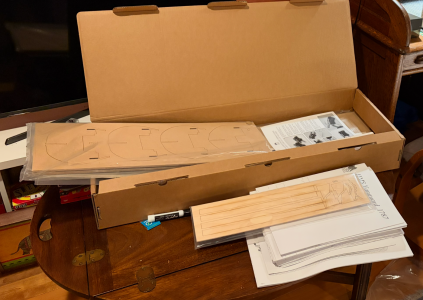

First notes on unboxing and looking a the contents:

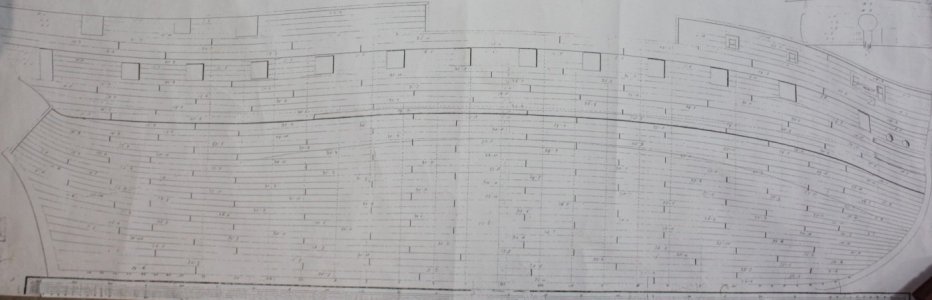

  1. The kit is gorgeous, the plans themselves are a work of art. I have hung one on my wall. I stashed the ones I don’t need currently in a drawer. There are several smaller boxes containing some resin parts, various railings, anchors, deadeyes, buckets, cannons, false-cannons, carronades, and blocks.
  2. A fancier kit will come with more fancy parts. I was pleased to see the deadeye chain plates came in photo etch; I had a devil of a time making them on my Frigate. The paper instructions are a nice change from the pdf I had to read from a CD included for the Frigate.
  3. I don’t think I could take a stab at this without having done a 3 masted ship before. I'm proud of my Frigate and I hope this one turns out even better. The larger size of this ship (over 1 foot longer than the Frigate).
  4. There are a lot of laser cut parts. The photoetch looks excellent.
  5. The cannon carriages are cast metal. I've seen others replace these but for now I shall keep them. I might 3D print some extra carronades for the quarterdeck, as HMS Elephant was equipped with these and Amati sells each of them at a criminal price.
  6. The copper plating will be a first for me, but that will only come many moons from now. It comes as sheets of etched copper that you can snap off in pieces

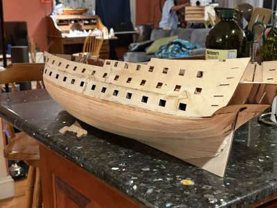

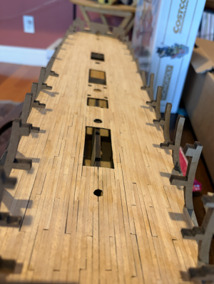

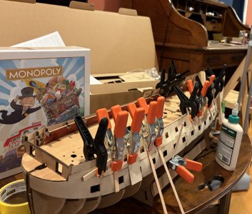

My existing model bench is somewhat smaller than the box, and so I commandeered a coffee table to assist in providing space. I still move apartments semi-frequently, otherwise I would buy a bigger craftbench. I aim to do as good a job as I can with the 2nd planking so I can preserve it un-painted. We shall see how well this goes.

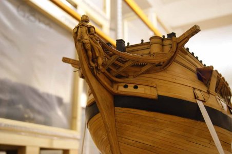

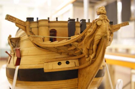

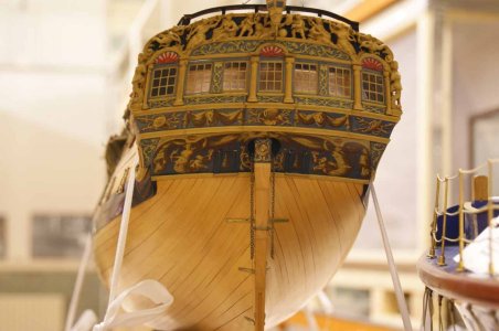

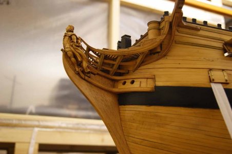

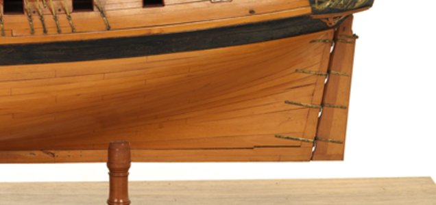

First, welcome to SoS Jan :)

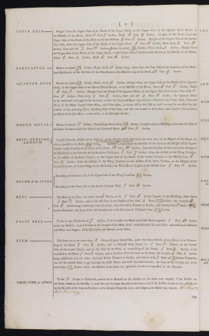

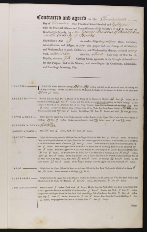

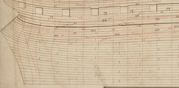

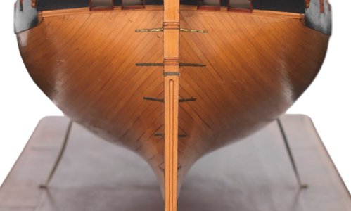

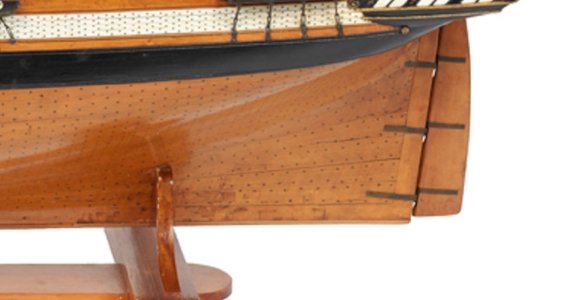

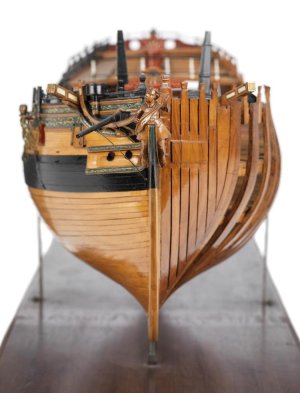

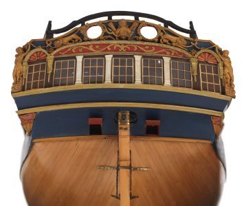

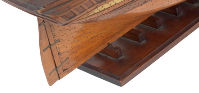

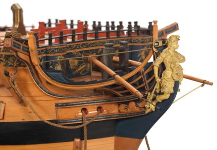

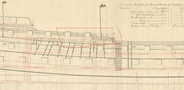

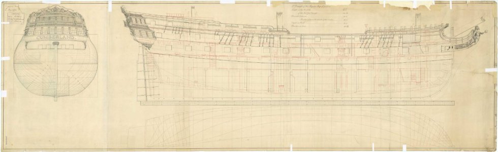

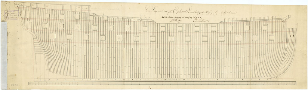

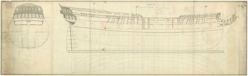

The Vanguard was an Arrogant class 74 same as the Elephant so a great idea that you have as there is so much information about her. Depending on what you are looking to achieve there is the original contract from for Elephant which gives dimensions of every piece of the ship and more. There are also a lot of drawings on the RMG Collections website as well. https://www.rmg.co.uk/collections/objects/search/Elephant 1786 plans
The contract was written earlier, 1781, but is described by RMG and on the cover page as being for Elephant, built by Parsons in Bursledon.
Cover page
Page 1 of 24 pages
Page 2
