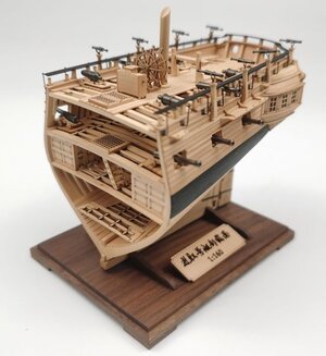

This is my build-log of the Enterprize stern-section in 1/160 scale by Chinese manufacturer Unicorn models. There are two wood versions you can choose from: Boxwood (buxus on the website) or Pearwood. I’m building the Boxwood version which is slightly more expensive. I paid 77 dollars P&P included. On the invoice the seller stated 10 dollar with is a nice touch from the seller so no import duties to ad to the price.

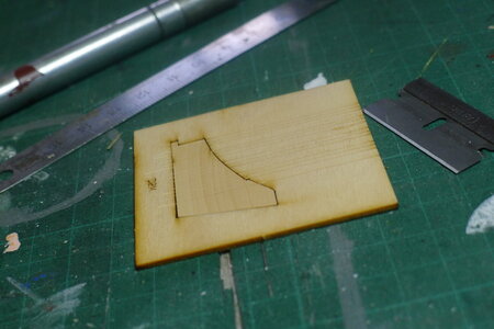

After studying the assembly instructions careful I made a start. Since the instructions are mostly pictorial and have some Chinese text and my Chinese is a bit rusty there wil be a lot of guessing, I guess….. All the parts are laser engraved and need some cutting to release them from their sheet of wood. I found out that a #11 knife was to thick to cut out the pieces, so I used a single sided razorblade.

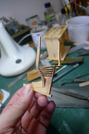

The first step was this deadwood/sternpiece jig. It took some time before I realized what it was for. The frame location is on the deadwood engraved on one side only, the other side you have to scribe yourself. This shows the position of the scrib lines. The pic shows the deadwood already scribed.

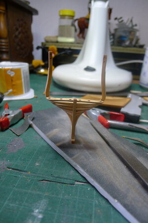

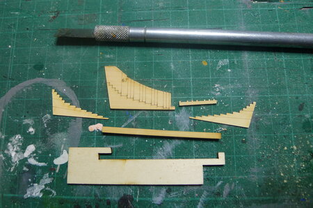

This pic shows the parts to be assembled into the stern part. Below is another jig for positioning al the parts correct.

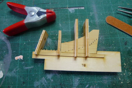

Here the assembly is shown with some more jigs to ensure proper alignment.

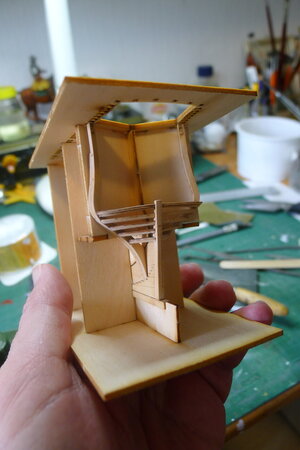

I started on the assembly jig (a lot of jigs so far). At the moment dry assembly only. Everything fits snug so no need for glueing.

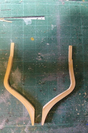

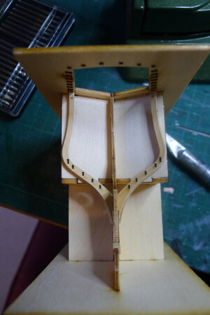

Working on the stern. It took some time to figure out how to approach the next steps. The photo manual was not very clear and with the translate tool I got only more confused. I studied the manual over and over and only after checking the pictures on the facebook page it dawned to me what I was supposed to do! L1040070.JPG
Still some clean-up to do.
The last part of the sanding will be done later.
