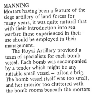

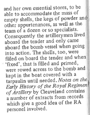

Are you saying that shells loaded with powder would never be stored in the shell room? I thought that was the primary reason for the shell room (other than making use of an available storage area). Per Goodwin, the crew loaded sufficient bomb shells for the day's bombardment before dusk; surely these would then be stored in the shell room, no? if not, where could the be safely secured?

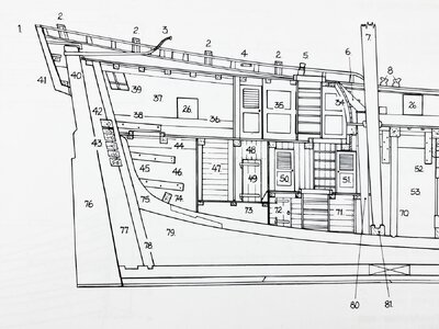

Sure:
The top diagram is what I believe the Granado should have. A fore capstan is shown instead of the windlass further forward on the Granado, but the operation would be the same. Per Lavery, the Viol came into normal use by the 1670s, due to the larger anchor rope size. The messenger began to be used in the 1730s to 1740s, when the main capstan became double, and ships with viols began to be converted to messengers, provided they had a central capstan, in the later 1740s, with most all larger ships converted by the 1790s.

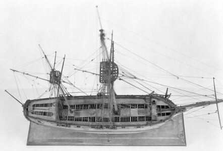

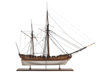

Not all smaller ships in the english navy had a latern at the stern - usually it was important for other vessels in a fleet or ships group to know where the ship(s) are.
F.e. the two masted Speedwell sloop, a Cruizer class, had also no latern - see the contemporary model in the NMM
I can imagine, that they were hanging a removable smaller latern at the flagpole or in the rigging of the mizzen mast if necessary
BTW: The Speedwell is also a good example to show the problematic with the location of the helmsman
