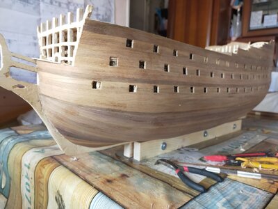

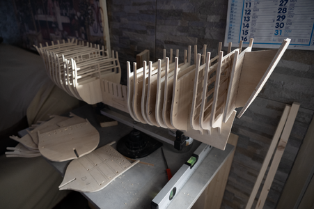

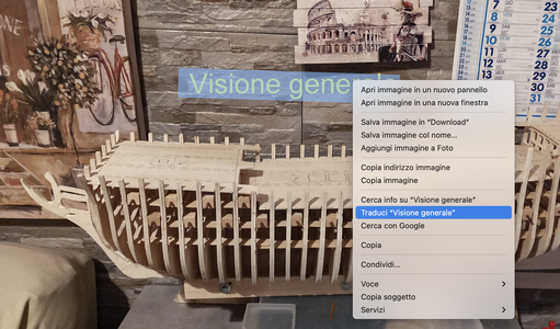

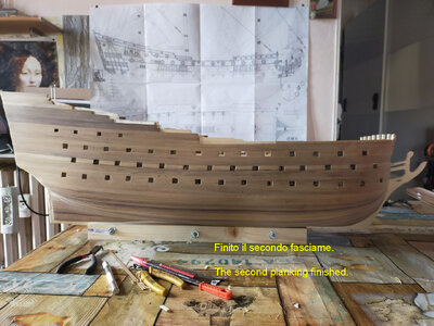

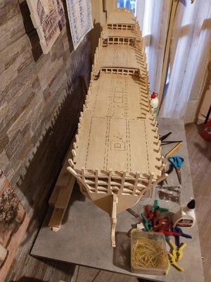

Start of work 26 November 2023. Let's hope for the best!

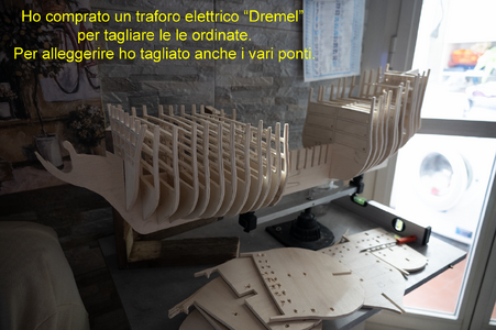

I am most impressed with the number of frames in this model. Unfortunately, the only available kit is the Constructo version. I have to agree that the latter model is detailed enough but lacks the structural strength of the Amati version.Start of work 26 November 2023. Let's hope for the best!

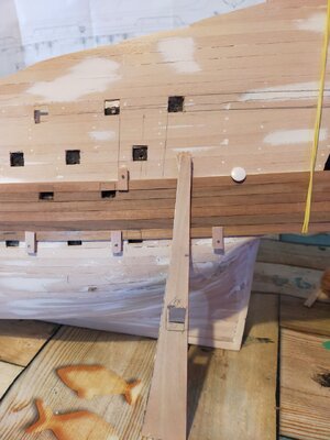

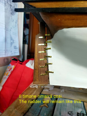

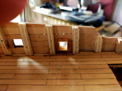

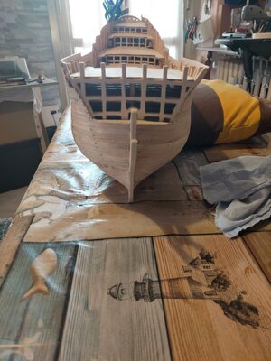

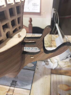

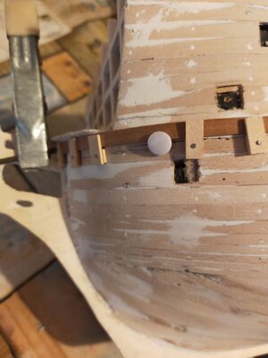

Hai ragione. Un tondino attraversa tutta la verticale del timone e passa attraverso i giunti e questo impedisce la caduta. Ottima osservazione. Grazie mille.You are a very fast builder - very good progress
Only one comment to the rudder - the hinges on the rudder blade should be above the hinge on the hull - like now the rudder would fall down
Maybe you have still the possibility to adjust this
