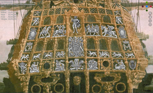

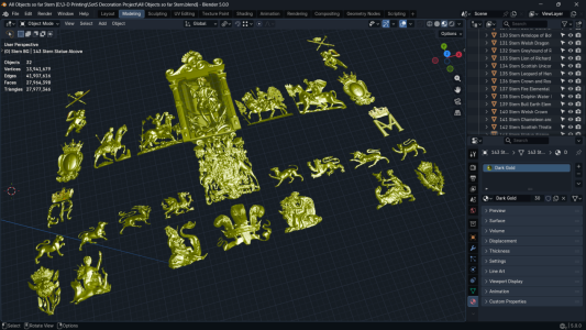

Columns, definitely. At the moment I started working on some of the other decorative elements that surround the icons, starting with the carvings around the central figure of King Charles I. Here is how that one is coming along. The gallery around King Charles below this is next, and that gallery may be merged with the figure of the King to make one large central assembly.

Fantastic results. One remark is there an option to slightly angle some of the emblemes at the corners of the stern. Your emblemes are now squared where they apear angled following thelines of the sides and friezes.
Vs
This would benefit the aestetics greatly.
Hi Kurt,
Vs
I noticed that also. It was easily fixed. Another minor issue is that the painting is not completely symmetrical, so theye may be some issues fitting the objects into the panel rectangles on the model, and adjustments to scale and shape in the 3-D objects will occasionally need to be made and repriinted on the resin printer.

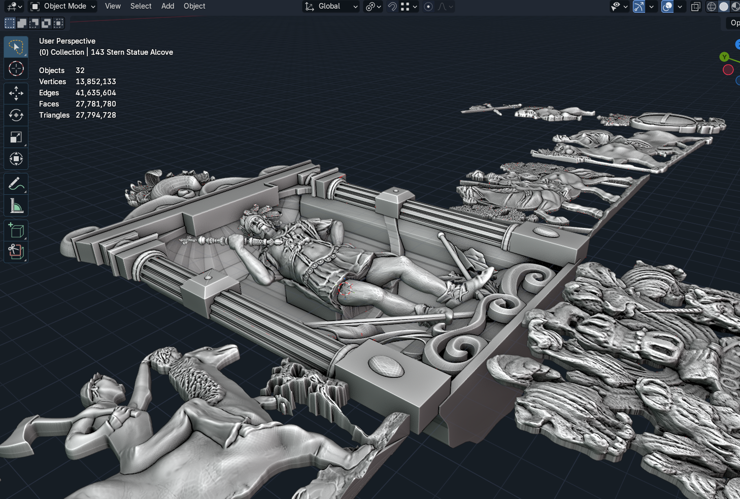

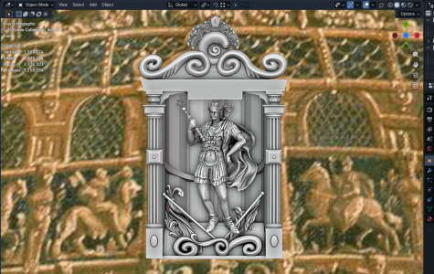

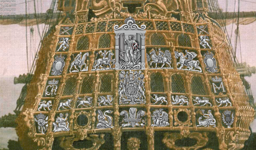

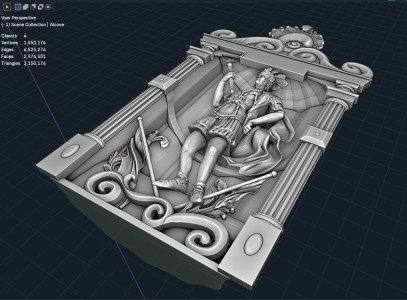

Mark P. noted that the statue alcove may project farther out from the stern that the surrounding decorations. Knyffe's painting hints at this, but a Van de Velde drawing of HMS Royal Prince has a definition protrusion of a very similar statue alcove to the Sovereign. In preparation for the change to the prominence of the alcove, I spent several hours optimizing the alcove mesh and thickening the columns so they will have more depth and not be as flush with adjacent decroation when attached to the ship. Below, the alcove is shown flush with nearby decorations. This will not be the case on the model. image.thumb.png.3ea51287eee5eb4f6c9d1d768cc5d231.png

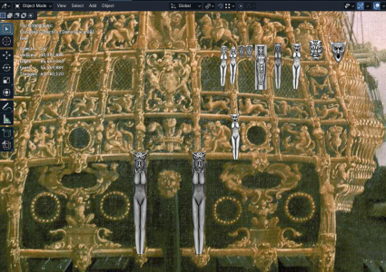

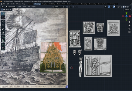

Work is slow as I try to gather and modify assets to make the columns (called brackets) between the decorations.
I have the two central brackets on the counter almost done.

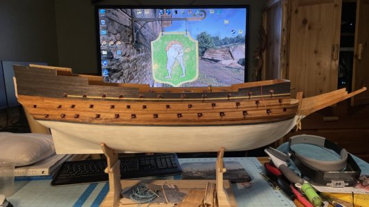

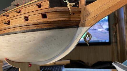

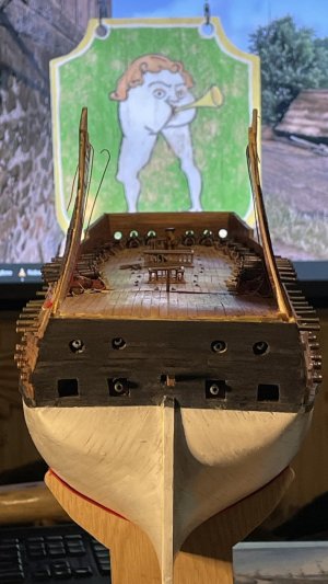

All this 3-D work is getting tiresome after two years. So, I pulled the model out from under cat-shield v2.0 to repair some damage. Two loose cannon barrels were locked down and the beakhead had broken off and so it was glued back only the stem, this time with brass pins to reinforce it. The seam was touched up with paint and the repair is practically invisible.
I noticed the rearmost portion of the upper gun deck has a bit of a twist compared to the forecastle areas. The area will be buried inside the stern castle, so I'm not too concerned.
Repairs complete. Back to Blender 3-D... :rolleyes:
