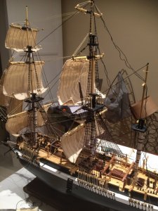

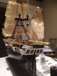

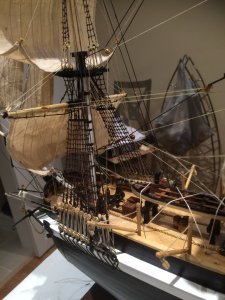

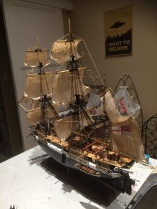

thanks for the encouragement. i soak the sails in boiled black tea for about 45 - 60 seconds, rinse with cold water and let dry then coat them with matt water based urethane . when almost dry i roll them up and let dry overnight . i can then pre -shape them and use the bunt, leech , clew and reef lines to draw them up to the finished look.
