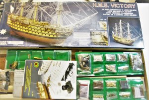

Kit Review / Look Inside the Box / Open the Box:

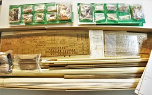

It is a heavy kit, appr. 10 to 12 kg

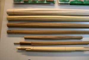

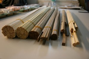

The wooden strips are looking good, not the highest class of timber, but good
the strips on the top (left photo) or on the left (right photo) are balsa

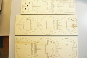

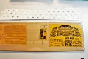

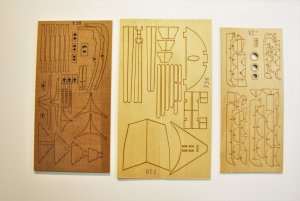

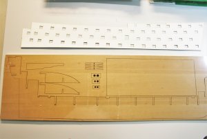

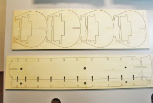

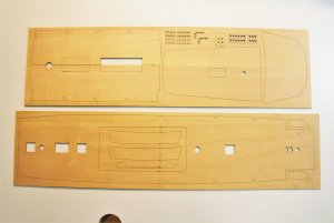

The wooden CNC cutted parts, better quality like Royal Caroline

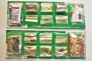

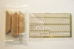

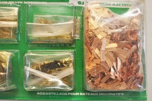

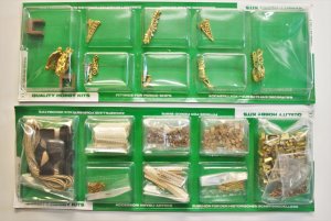

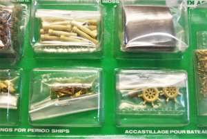

The small parts and fittings are packed in four boxes:

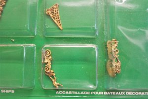

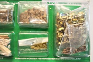

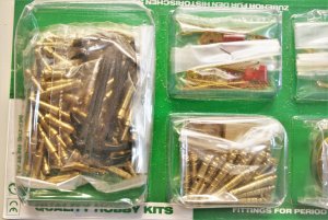

Some closer photos, to get an impression of the quality and content (some parts are out of scale f.e. the steering wheels)

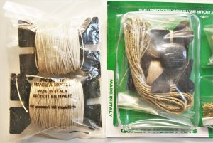

The ropes for rigging.
Here some negative comment: There is no dark brown or black rope included for the standing rigging, only light color
Already visible at the advertisment photo of the finished kit model, that only light color ropes are used for standing and running rigging

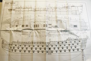

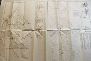

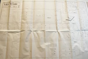

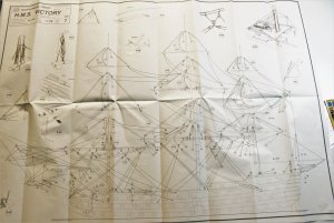

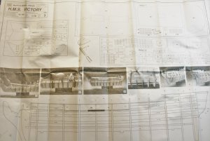

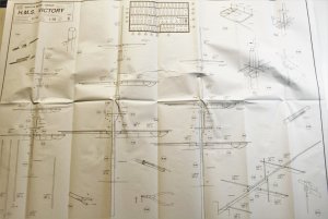

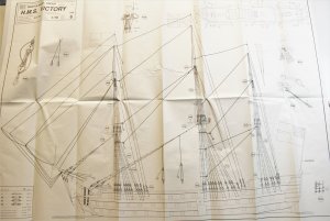

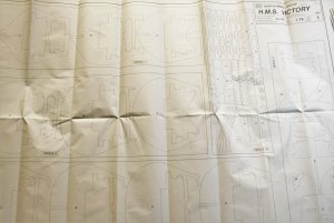

The drawings which come with the kit are shown in the next 8 photos.
Yes, for this size of model the manufacturer is giving only 8 drawings on 4 papers into the kit, means double sided printed paper.
And already 1, 2 and half of No.3 are drawings are needed only for the content-control, so not necessary for construction.
The last drawing No.8 is optional for the sails => Only 5 and 1/2 drawings are for construction. This is in my opinion much too less information.
So you need in my opinion in addition some books for reference f.e. the Anatomy of Ships by John McKay
See my Book review: The 100-Gun Ship Victory (Anatomy of the Ship Series)
Missing is also f.e. a belaying plan for the rigging
Content control drawings:
Hull construction and deck:
Masts, spares, standing rigging
Running rigging and sails

I also have this kit, I inherited it from a friend from my father who past away some 20 years ago. It was already partly build. There is a hudge mistake in this kit the wales are following the black and yellow pattern as you can see on the drawings. This is incorrect as the wales in the original are crossing the gun ports in the aft ship and only the paint is following the deck. In my model it was to late to correct this but if you ever decide to build it you can redesign it properly.
For the HMS Victory model, above, by Panart/Krick, you note that this model is plank on frame. However, your pictures of the parts seem to show a series of bulkhead parts. Is this a plank on bulkhead model or a plank on frame one? thanks for any clarification you can provide.
Like @Bryian mentioned already - it was a mistake in the description (taken by the manufacturer) -> off course it is bulkheads.
I edited corrected the original text. Many Thanks for the hint and many thanks also to Bryian ....
