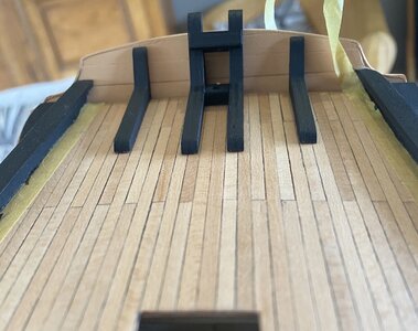

This morning I made the flag pole holder and supports. As per the kit. The Victory in Portsmouth has a metal fixture to hold the flag in place while these are wood, however I’m happy with the kit look. The flag wardrobes provide in the kit are horrid so I will attempt a build of these. I have dry fitted these as my stern railing and paint needs some work still.

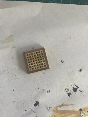

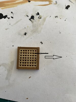

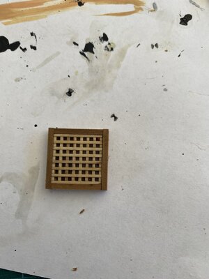

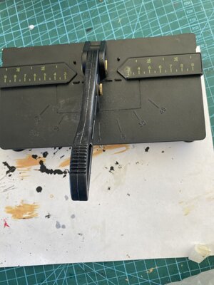

I got my first hobby tool. Gave it a go this am and it definitely produced a better result framing my grating than my attempts with a hobby knife. Was a little disappointed with the measurements on the cutter, however I’m sure I can add these myself. I am going to leave the grating frames walnut as this goes with the rest of my model. I see on the real Victory they are are more rounded shape and have a darker gloss stain.

Nice grilles. There is a little bit of work to be done. The bottom of the comb should be flush with the top. Rub a little on emery. The upper combs should be located on the ship parallel to the DP (diametrical plane), i.e. look forward or aft.28F72FE0-9FD5-4061-B03D-E6029DC7E0C1.jpeg
@Alexander74 - Sasha I reworked my grating as you suggested. Looks sooooo much better. Thank you. I also reduced the height from 4mm per instructions (just looked bulky) to 3mm.

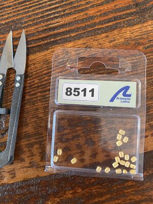

My order of blocks for my quarter deck cannons arrived and a thread trimmer. These work a treat so happy. I found a on line store in SA which stocks Artesania product and I don’t have to wait 6 months to receive. Excellent.

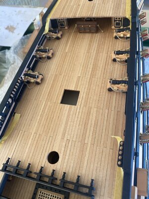

Quarter deck cannons installed- using what I had and poetic license. Keeping away from rope coils on the recoil. I also increase the thickness on the breech line to 1mm from kits 0.5. Cannons not glued as I still need to inhaul tackle and align them.

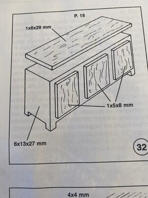

I made a compass table. The kit was like a block - strange.
I cut holes in the block, added some drawers and draw handles(nail heads), stained it and polyurethane. Little more authentic.

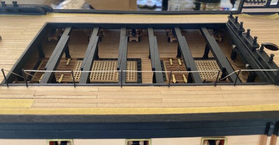

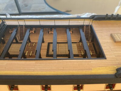

Making some progress. Ladders to the upper gun deck have been made and fitted on the port side together with the Stanchions and rope railing. Ladders shortened,shaped,stained and Matt poly.
Attaching rope railing was a challenge- seizing and knots came out to bulking and just out of scale? Used CA glue and looks super neat but not accurate- will have to research here a bit.
