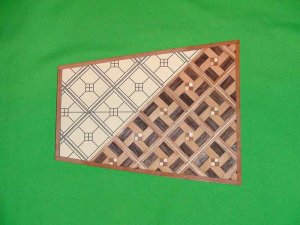

The model and kit also featured a very special parquet floor in the great cabin. This floor used a number of species of wood including boxwood, holly, and swiss pear.

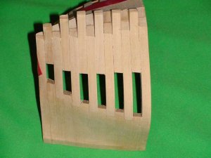

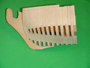

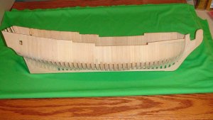

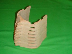

These first photos show the construction of the frames and the framing of the hull. Single futtock style framing for a Navy Board model does not require any kind of building jig.
There are certain steps that the builder must take to ensure that the frames are plumb to the work surface. This plumbness is achieved using a carpenter's square and special drawings with alignment marks that I provided in the kit.

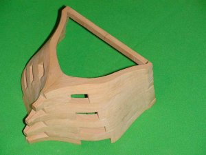

The frames consisted of several CNC milled parts. There was a frame drawing of each frame which showed the layout of the frame parts. The frames were assembled as a continuing stack thus forming the hull in sections as you joined one frame to the next and then the sections were joined to each other.
After all of the frames were joined together, the keel, stem, stern deadwood and sternpost were added.

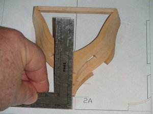

This first photo shows frame 1A laid out on its associated frame drawing using double sided tape.
Next, frame 1, which was actually in front of frame 1A was attached to the surface of frame 1a. Please note that the bevel lines for each frame were shown in the drawings for both the inside and outside edge bevels. The frame parts were beveled first before being added to the growing stack of frames.
A carpenter's square was used to check alignment along the centerline. Cross pieces were added to the whole frames to align the top along the centerline.'
The assembled frame parts were then added to the next set of frame pairs, 2 and 2A and so forth making the hull grow from bow to stern.
Sections were built up in 6" lengths and then set aside to be later joined to each other thus forming the entire hull.
As the hull grew in length, the stem was added.
The mid section was built.
The stern section was built and joined to the other frame sections. The stern section frames were designed such that once they were assembled, they formed the stern deadwood. Most construction I've seen of Navy Board models used a separate stern deadwood piece that had to be fitted between each frame. That requires precision cutting and fitting. My method produced the same visual results but was much easier because the deadwood was actually part of each frame part.'

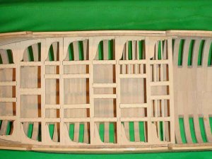

And finally, remaining keep arts and sternpost were added, wing transoms and other transoms were added and a final upper side piece was added to form the entire framed model.

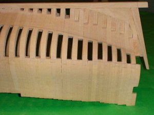

Also, you'll notice some pencil lines in the next to the last photo across the hull. These were used to trim the frames in the open areas so that a smooth line of transition was formed from one frame to the next across the entire hull. This is a signature trait of the Navy Board model style.
Bob

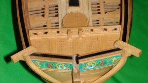

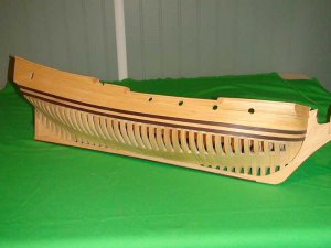

The next photo shows the framing of the stern transom.
Once the transom was finished the upper hull was planked leaving the open framework of the lower hull visible in the Navy Board style.

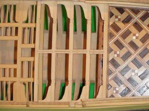

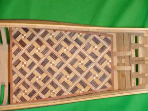

The great cabin in this kit had the parquet floor shown on Portia's plans. This was duplicated in the kit using some laser cut parts in boxwood and various pieces of stripwood in walnut, holly and cherry. The floor was constructed on a piece of cardstock that had the pattern laid out on it and was included in the kit. The next two photos show the construction of the floor.

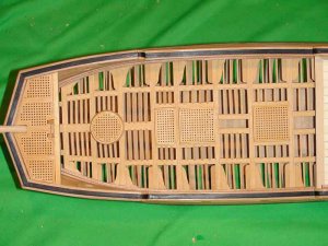

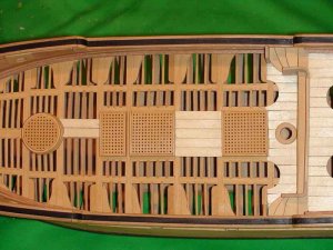

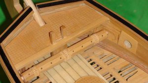

Next, the main deck was framed using CNC milled deck beams and lodging knees combined with various pieces of stripwood. The deck beams were built up in 3 layers. The two outer layers had notches milled into them for the carlings.

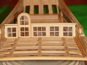

The quarterdeck was framed in the same manner and the glass windowed bulkhead on the forward side of the great cabin was constructed and installed. The great cabin has a sunken floor meaning that its deck level is below the deck level of the quarterdeck.

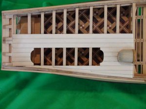

The poop deck over the great cabin only had deck beams - no carlings or ledges. It was framed and partially planked so that you could see the deck framing and the parquet floor n the great cabin.

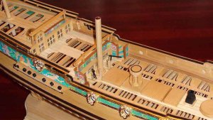

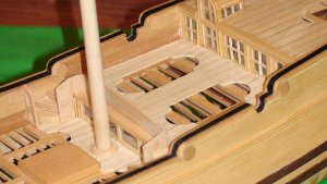

After planking the poop deck, the quarterdeck was planked.

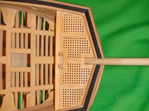

At the fore end, the forecastle deck is created with grating parts.
Now you can see the framed main deck and forecastle deck with the hatch combings and gratings.
This photo shows some of the decks from a perspective view.

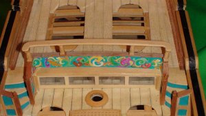

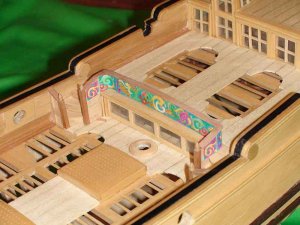

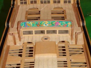

Railings were added at the fore end of the quarterdeck. The paintings were supplied in the kit as printed sticker paper that were simply peeled off a paper backing and stuck onto the railing.
At the fore end of the main deck, a windlass was added.
Going back to the quarterdeck rail, additional details were added which included a handrail and the stairs had sticker paper paintings added to them.

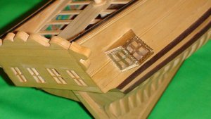

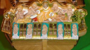

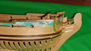

Some work on the stern transom and side galleries. It should be noted that Portia's plans show cherubs over the top and bottom of the side gallery. My skills were not good enough to carve those complex figures so the kit included an alternative, simpler side gallery.
At the forecastle, a railing was added on the aft side. Sticker paintings were added on the forward bulkhead, catheads were added, and the head rails were added.

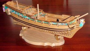

We're in the final stretch now.

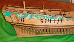

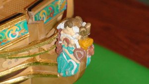

The kit came with several resin castings for the figurehead (a left side and a right side), the cherub surrounds around each gunport, and the stern transom carvings to name a few.

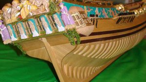

The painted frieze was printed on sticker paper so that it could be peeled off and stuck to the side of the ship.
The stern carvings were painted and attached to the stern transom.
The figurehead was painted and added to the stem.
And last but not least, the model was mounted on it's kit base using resin cast crowns that were included in the kit. The crowns had jewels glued on them first which were also included in the kit. Since it was meant to be built in the Admiralty style, only stub masts were installed.DSC00618s.jpgDSC00679s.jpgDSC00681s.jpgDSC00688s.jpgDSC00705s.jpgDSC00722s.jpgDSC00725s.jpgDSC00732s.jpg
