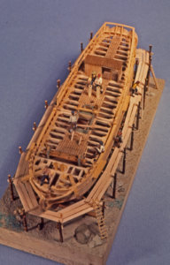

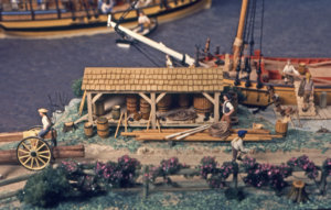

HO scale can produce stand along ship models as well as ship in a diorama setting where the mode builder can really expand their modeling skills.
a HO scale laser cut model of a schooner can be done very inexpensively because it is small enough a lot of parts can be put on one sheet of wood.

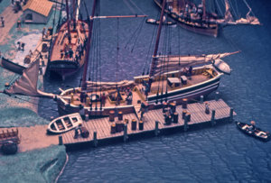

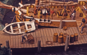

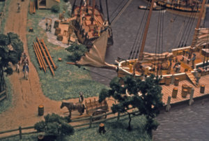

this is all HO scale done by Harold Hahn

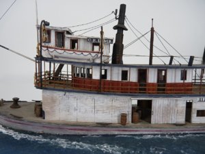

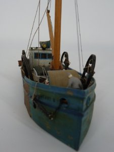

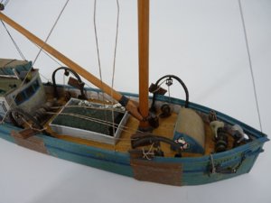

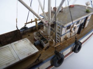

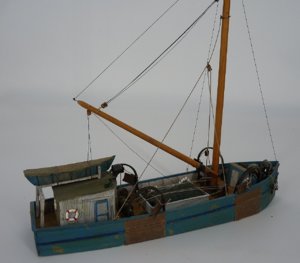

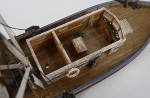

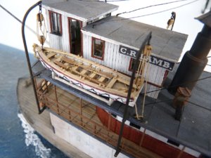

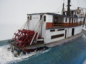

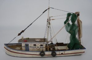

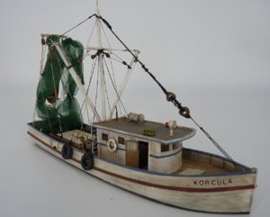

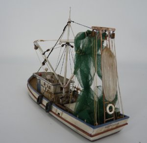

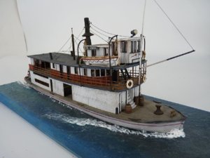

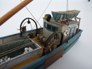

Now your talking my scale :) I have scratchbuilt two fishing boats, the first the Sherry K. after my wife, and the second, a little more ambitious after an island I went to in the Mediterranean, the Korcula. I was vacationing in Yugoslavia at the time. The steamer, the C.R. Lamb, started out as a kit, but I did a lot of scratch building on this too, replacing the railings, building my own lifeboats, and several other details. I have no layout for these, but plan to do a wharf diorama one day.
Great models, Nelson!!
Thank you Jim, and I always forget to include my name, my bad. I don't mind Nelson, he has been someone in history I enjoy reading about, although not enough of, and that name is used by others on other sites.
I noticed too, the ropes have loosened up over time, since I built the Sherry K. They were a lot tighter. I need to fix that somehow.
So, now I will close with my real name. :)
Tony Burgess

hundreds if not thousands of products are produced for HO modeling and we have the know how to create HO scale ships in finer detail timber for timber

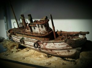

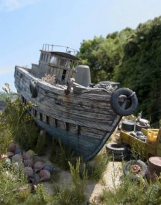

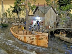

View attachment 118141View attachment 118142View attachment 118143
I absolutely love these three boats. The rust, decay and neglect are hard to duplicate, and something I will want to try one day. It's getting my juices flowing already, and since I do mostly dioramas, I can fit this in for a scene all it's own, as appears these are. I went to a 'bone yard' on vacation once, forgot where, to be honest, and took a lot of pictures, if I can remember where I kept them. One boat in particular there was in a similar state, and apparently under repair. going by the amount of scaffolding around it.
