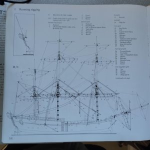

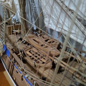

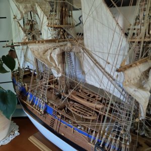

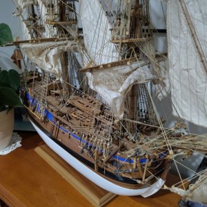

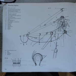

Hi Schiffs. If you want to go the full deal regarding rigging I would recommend this book. "The anatomy of the the ship Captain Cooks Endevour" I used it several years ago on the same model you're working on. Just to give you an idea of detail I included a few pics from the book as well as a shot of a section of the model I completed a number of years ago. Ignore the dust.

Thank you, Rick Noyes. Just ordered the last book from Amazon. By the way, I have read about 3 books on James Cook, but I never came upon this one by KH Marquardt.
