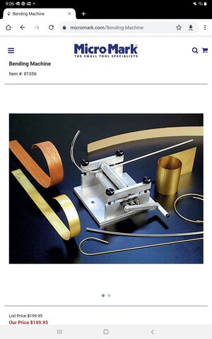

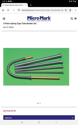

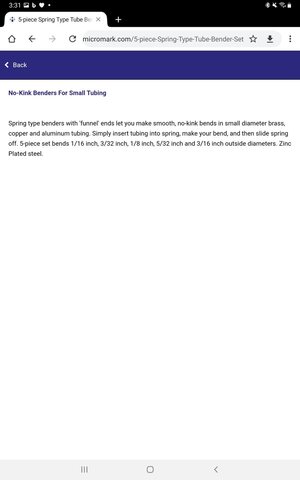

What diameters are you considering? There are springs you put the tubing in before bending. I bought the Micro-Mark bender primarily for bending wood but it also has grooves for roller bending smaller tubing. Anything much larger, you can use a tubing bender.

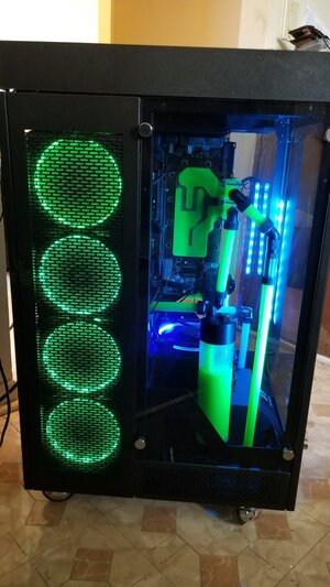

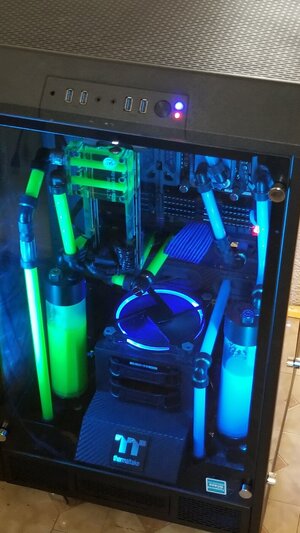

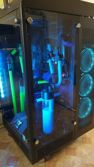

Another hobby of mine is building custom, water cooled computers.
I always need to bend clear PVC tubing, by heating it up with a heat gun. To prevent the tubing from collapsing, I insert silicone rods. Once the PVC has cooled down, you just pull out the silicone rod.
I'm confident you would be able to do the same with brass tubing. You would most likely need to lubricate it with mineral oil or another lubricant. The only challenge I see is finding it in smaller than your 3mm OD. With that said, you can search for "silicone rods". Good luck!
