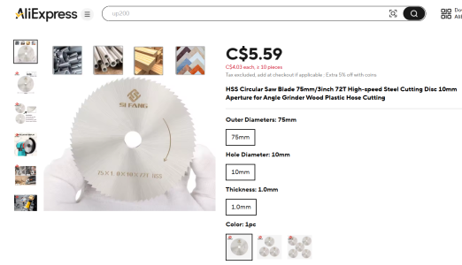

After having its fence fixed with method I described at the beginning it does same job as famous Byrnes saw but for half a price. For accurate cuts I also discovered proper blades which Proxxon does not make. These are slit type blades which look like milling blades - lots of small teeth.

The section of blades from Proxxon is almost none existent.
I do propose to turn metal bushes to allow the use of milling machine slitting blades, almost infinite choice of tooth count and kerf width
