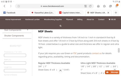

I understood what the M means, but it must represent a range because I see listings like shown below. You would think "ultralight MDF" might be an oxymoron, but you can buy it in the US. I need to find a Canadian source, in maybe 2 x 2 ft (60 x 60 cm) because we are all in lockdown here in Ontaro, so all my shopping is online except for groceries and drugs. I can use plywood, but I like my experience with the mdf on my current kit, but the last plywood we used had voids in it and the interior plies were brittle.Screenshot_20210115-180213_Samsung Internet.jpg
That could be. It's the type of thing I'd like to know. There is apparently a grade you can get that resists moisture, but it may then not accept water based glues? Maybe I will pursue the plywood route.
