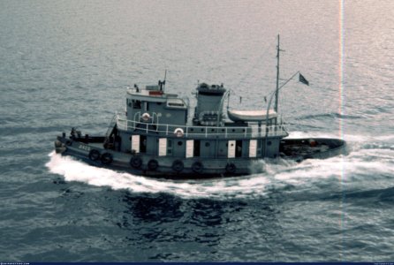

For Perseus itself, I have five pictures from my dad’s archive and a couple of pictures from the web. One in particular from the web was of immense value as it was in colour and taken in 1971 by D. Boyd onboard the USS America (no less!) only a couple of years after my dad’s service with the tug. This photo confirmed colours and fittings and is my main reference and can be found at shipspotting.com
This photo is funny as the whole crew is on deck to marvel USS America. Great photo!

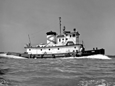

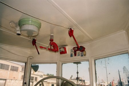

Another set of extremely valuable photos was from the OLP 1 (ΟΛΠ) tug which was another DPC boat aquired by Greeks and used at the port of Piraeus for many decades. The US Army story of OLP1 is still not clear, but in time I will investigate and get to the bottom of it. Some confuse it with ST772 and Perseus but it's not true, these were two different boats.

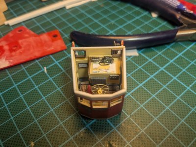

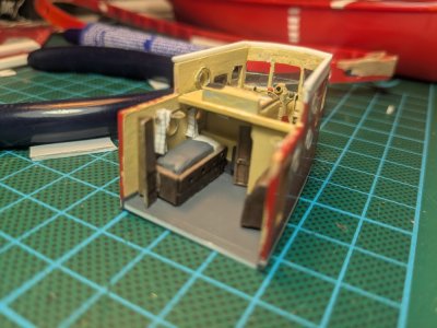

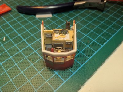

However the amazing OLP photos are the only I could find of the boat's interior and were the basis for my main modification of the kit which was to reconstruct the pilothouse and captain's cabin. With those photos and an extremely valuable plan of the boat I found online, I designed the layout. The good friend of my dad’s that served with him, confirmed with me the colours and layout of the pilothouse.

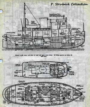

The plans are also not perfect but it's a great reference. I scaled them in the printer the best way I could and it was clear that I would need to introduce changes to the pilothouse and the boat. I also found a German modelling forum where a very talented modeler named Harald went through a similar process and has excellent documentation of the changes he employed. Very inspiring built.

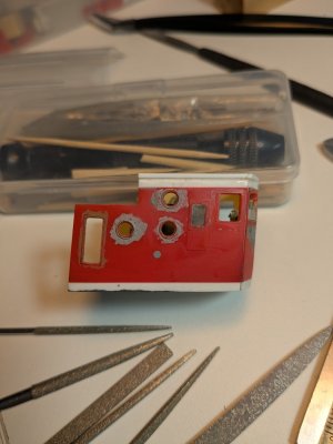

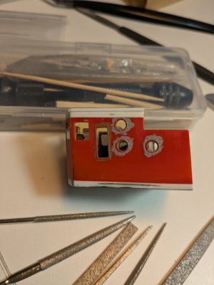

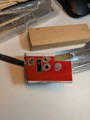

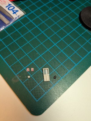

So I scrapped what I had done and started almost from scratch. I say almost, as by then I had already successfully filed out two doors, so I can have them open to increase the chances of seeing better the internal details and etched with a pin the door frames internally. I had also built the cabin furniture, the two engine telegraphs, the wheel, radio, binoculars, clock and various other fittings. I also made windows from old-school presentation sheets.

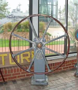

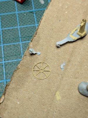

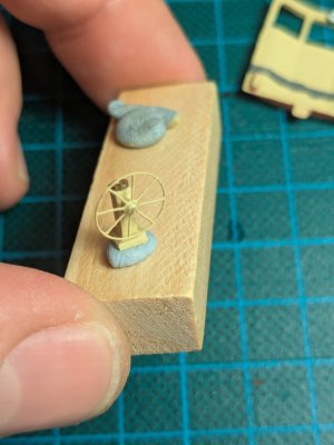

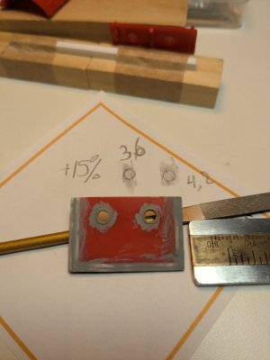

Regarding the pilothouse wheel I was very happy with the result. This came out of an etched product, designed to be a fire reel for 1/350 that I came about by chance and did my measurements and took a chance and bought it.
The binnacle was an amazing 3d print by Mark on eBay aka mustangmark67
Simply amazing custom scale print at an amazing price, great guy!

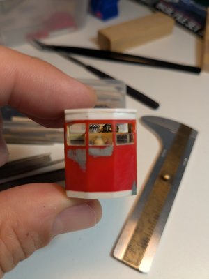

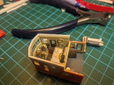

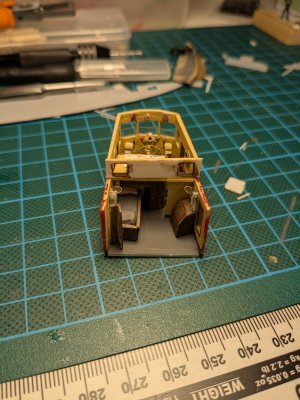

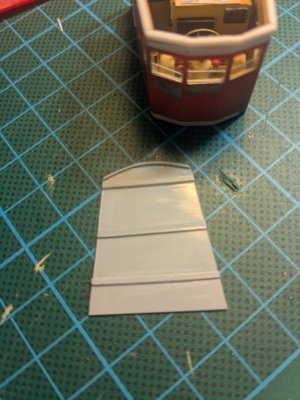

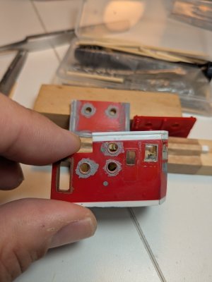

At the moment the pilothouse internals are almost final but there is still work on the pilot house roof. I also increased the sizes of the window as they are smaller than actual.

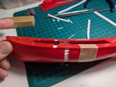

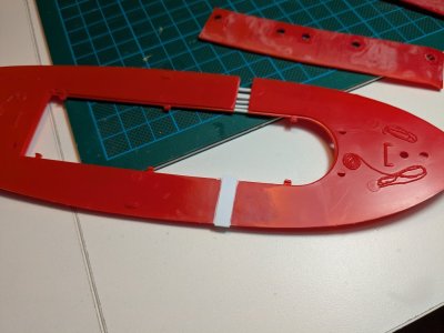

Next the hull will need extending by about 5mm so will the accommodation. The front mirror will need be done from scratch as its shape is incorrect. I am planning to file away all details in the model and remake them from scratch close to the real thing.

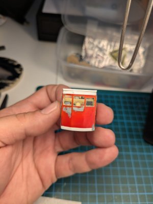

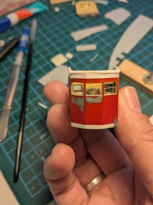

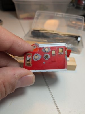

The state of the pilothouse after enlarging the windows (compare with portside)
Extending the hull by 5mm
the fantail will need some enlargement as well on the sides

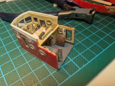

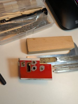

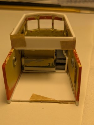

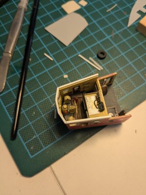

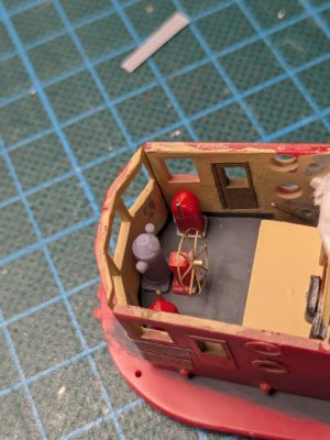

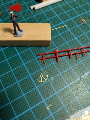

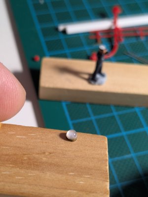

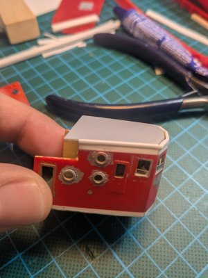

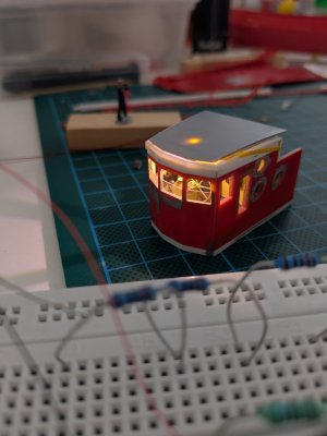

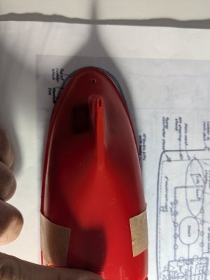

In the beginning I impatiently started reconstructing the pilothouse. I just had to start building, after all these years thinking that the model is accurate! But the more time I spent time working on it and looking at pictures it became evident that some things quite off. Not dramatically, but enough to render modifications to get closer to reality. With the plans at hand that I found online, I confirmed my observations.
