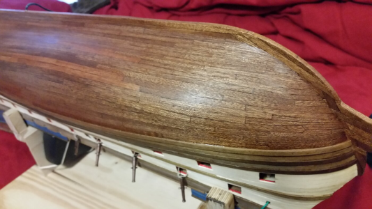

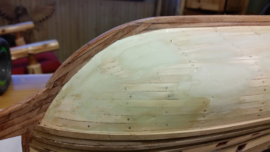

I was starting to suspect the moisture in the acrylic primer and rattle cans was affecting the wood and paint job, so what you are saying makes sense. The moisture is probably making some planks expand and with nowhere else to go, bow and curve outwards away from the hull. I'm about to start planking another ship and will definitely source some solvent based primer as a base coat. Thanks for the advice.
Thanks,If they are standing proud it may be that they are raised from edge bending straight pieces of planking. Are you pre-shaping the planks properly so they lay in place without having to force them with more than light finger pressure? If the planks are properly pre-shaped they will not raise up and you will not need clamps to hold in place when gluing them.
Yes, I sometimes soak and clamp them to the hull overnight to dry. I'll get better after help like this
Cheers
Thanks Bob,I suggest that you sand using a suitable flexible batten. This is just a thin, flat stick (of wood or other material... a spring steel length of packing banding or a flat length of stiff plastic) with a piece of suitable grit abrasive sheet glued to its surface. (You can use feathering disk adhesive used for gluing abrasive sheets to rotary sander pads, if you can find it at your local auto supply store, or rubber cement thinned with a bit of acetone.) Glue a small block to each end of the top of the batten to make it easier to hold each end. The batten will conform to the general shape of the hull when you sand while gently pressing it uniformly against the curve of the hull, producing a fair finish without bumps and hollows. Start with coarser grit abrasive and work down (towards higher grit numbers) until you get a finish as smooth as a baby's bottom. Apply a base coat after the surfacing putty has filled the worst of the defects and expect to have to make two or three runs at sanding it before you get all the defects filled. There's no substitute for being OCD about the process.
Before going further, in case may be unaware, you should not attempt to achieve a good fair surface for applying any sort of water-based coating (i.e., acrylics) to bare wood. The water in water-based coatings will be absorbed into the bare wood, which will tend to absorb more water into the soft wood between the grain, causing the wood to swell and then, when dry, shrink, leaving the harder grain standing proud. There's no point in trying to sand a piece of wood that's going to move. I've found it best to seal all bare wood with clear ("white") shellac before applying any other coating or filler. The shellac, which is thinned with alcohol as its solvent, readily soaks into the wood and, when the alcohol evaporates, leaves behind as effective a moisture barrier as can be hoped for in any coating system and a shellacked surface is compatible with any subsequent coating one might wish to apply over it. Shellac also "hardens" softwood surfaces so that sanding doesn't "raise fuzz" on the surface of softer woods such as basswood. As for the use of water-based coatings generally, the technology has improved greatly in recent decades, but the fact remains that water-based coatings seem generally to form a more flexible film than oil-based coatings (enamels, etc.) and the more flexible films are simply a lot more difficult to sand. In its simplest example, a latex paint will form a latex film which is essentially a rubber coating. If you're old enough to have ever tried to sand a bicycle inner tube to key the adhesion of a rubber cement patch, you'll understand what I'm talking about here.
To get the worst of the imperfections, I use Interlux Surfacing Putty (https://www.amazon.com/Interlux-Y257-PT-Surfacing-Putty/dp/B0000AY85D/ref=sr_1_1?adgrpid=1342504259915083&dib=eyJ2IjoiMSJ9.Gz17nVrpFVxKQ8P_6sDBQPPgXDSMiQW3w5iBublcDl_m_jTVkBjHLN9H2edp1EYe6h8t6UefoL6XgiogtMHS0_Vr7qm0FLq5A20SIi-lVWrTceFn1DNcvCI_bVPEdGY9._g6lfx8ktMBts3uGo5YSTAWIUkPRsvsHbeCKQJsGlqE&dib_tag=se&hvadid=83906731284955&hvbmt=be&hvdev=c&hvlocphy=88716&hvnetw=o&hvqmt=e&hvtargid=kwd-83906856471787:loc-190&hydadcr=4123_13164389&keywords=interlux+surfacing+putty&msclkid=2aecc6cbc93512a898d3a1e3959983d0&qid=1730698422&sr=8-1) which, like everything else, has gotten rather expensive, although a pint can, kept well sealed, should last for many models. The stuff is thinned with acetone. A bit added to the can every now and then and the can left upside down overnight to absorb will keep the mix at the texture of peanut butter. Apply thinly with a palette knife. The stuff sands like butter and has a very fine grain. You'll probably be able to find an equivalent product at your local auto body and fender materials supply shop for less than the Interlux marine product. (Most drywall "mud" is much too coarsely ground and absorbent for a perfect scale finish.) All fillers and surfacing putties must be primed, or they will "stand out" when a finish coating is applied due to their different absorption characteristic from the adjacent coating.
One more generic caveat for the uninitiated: If you wish to have any chance of creating a perfect finish on a model, or anything else for that matter, scrupulously ban from anywhere you may ever want to do any finishing the presence of any sort of silicone material, particularly aerosol canned silicone spray lubricants, but also any cured silicone you may attempt to sand... heck, any of the damn stuff at all. Silicone has a very bad habit of contaminating large areas wherever it occurs. If as much as a microscopic speck of silicone material is transferred to a surface you wish to paint, that speck, which may be so small as to be invisible to the eye, will create a "fisheye," a round surface defect in the finish resulting from a variation in the surface tension of the liquid coating. It's near impossible to cure this defect because sanding it out only causes the offending speck to move elsewhere, or even multiply, only to reappear when the area is coated again. Silicone "fisheyes" are so much of a problem that most commercial finishing shops, such as auto body paint shops, have strict house rules preventing the stuff anywhere on their premises.
There is a product on the market sometimes called "sanding primer" or "sanding basecoat," among other things, which is, essentially, a primer paint with finely ground chalk ("whiting") added. (e.g., https://www.amazon.com/Rust-Oleum-249279-Automotive-11-Ounce-Filler/dp/B003CT4AM0/ref=sr_1_1?adgrpid=1337007374146822&dib=eyJ2IjoiMSJ9.Xc9akm7G9iaeig-88X5-Lmg0S_LIG1z24kWXtpzohABPdrOB-sHewcxjoSSQnaWe1LqqQu6U2ejwBLtVDMj7B9oDq8vmSuT1lQBloM6ZATl6Z6_67YcuVExKNEGF7V_SOa6QMR4eEjiukuOQvys7ydI-MmfHPISzZoIgnLgRaVQw8hGgpDqrzuMrSeblC-E8qcVmDCRG2paFVxAo2JrKRNDCobOe6yEIzIpVz0JnJUrUY_VNkanLBOt3QlrfYC_37QUQ7832wV_HdGUKFMeoqPyjH0xw4kJUoxLadks8Dhw.5AKNtDwZPxaWcYSZXp--Vq4x83-Lpb9QPcbv1N09JDw&dib_tag=se&hvadid=83563157972176&hvbmt=be&hvdev=c&hvlocphy=88716&hvnetw=o&hvqmt=e&hvtargid=kwd-83563772428900:loc-190&hydadcr=18754_13468636&keywords=automotive+sanding+primer&qid=1730699088&sr=8-1&th=1)Use this to (spray if possible) to seal your faired hull and then sand it using a sanding batten with very fine abrasive sheet applied. As long as you don't sand all of your sanding primer off (in which case you must apply another coat and sand again) you're good to go with your finish coat after sanding your sanding primer down to at least 320 grit or finer and then scrupulously cleaning every speck of dust off of the surface. Use a painter's "tack rag" to do the final cleaning. (https://www.amazon.com/MāKRS-Particles-Woodworking-Varnishing-Anti-Static/dp/B0CCXJSC6R/ref=sr_1_21?adgrpid=1334807683666564&dib=eyJ2IjoiMSJ9.4CEmo49Nznv0asTw6FCQ2sUOxaTvNwxNdhEsyXq_0BWgF7gJsx8hz5rK97XdRaNrF7bi7FSd9LMFjBC4IvPo8dt9tsOV2CZgB5QIY_UvNaieXC3TwtsCbMsFAuIGE7mQMtjdBPDjewVNJMHhpC_B12CwBLK-S7PQtvdfg4jc2CYnvj9DWLu8yWa_MneeOeRRWZk_SNkYvbZCv1QZtBuNNbyh_IBPlSbl4vdDHkHdfXk.0Wn2D4_7Dle4nU0-Vb6caeh1KXKM7otGy_fGZxeXnok&dib_tag=se&hvadid=83425803218069&hvbmt=be&hvdev=c&hvlocphy=88716&hvnetw=o&hvqmt=e&hvtargid=kwd-83425835450304:loc-190&hydadcr=2079_13504090&keywords=tack+rags+for+painting&msclkid=362387abfd46137880bae08395fa4fcf&qid=1730701508&sr=8-21&th=1 ) This "tacky" cheesecloth will pick up all stray dust particles. They are sold in any paint store. (Read the instructions. There's a particular way to progressively unfold the pad for use. Keep it in a zip-loc plastic bag after opening to prevent its drying out.) In addition to strong cross-lighting, use your fingertips to feel for any imperfections. Your sense of touch is more sensitive than your eyes for this.
