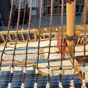

I thought I should write a conclusion to my original post.
Pictured is where I am at with my problem. It is not perfect but
as you can see I am working up in the Rat lines and improving
as I go. I feel I am now able to tie a good knot.
I learned that I have to break every operation down into each
individual step and overcome each problem one at a time. That means making one motion
securing and then proceed. As simple as running a rat line up and over the shroud then stop and secure
then proceed to the next move. It is time consuming but it works.
The most important thing is keep going, over and over try to improve.
I understand this is not helpful or relevant to most but if anyone reads this and needs encouragement like
I did maybe this will help. There were many time I walked away and almost quit but I am sure glad I didn't.
