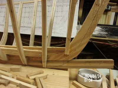

The usual method is to have a stem/apron - keel - keel/deadwood - sternpost as a starting unit. Where the deadwood begins the frames go from being full cross frames to being half frames that butt against the deadwood on both sides. I think that "intersect" may mean that a channel was cut into the deadwood as a socket for the heels of the frames. Something that a router or dido blade would do now? On a model, I am not sure that the difference between a simple butt and a routed channel can even be seen. An easier way would be to have the actual deadwood be lower - have it stop at the bearding line - use full cross frames all the way to where the cant frames start - or go full on stylized and use full cross frames all the way to the sternpost = no cant frames to futz with. Do the same at the apron. The cost is having to remove much more wood to get the bevel. The gap between the frames would be filled with a vertical pseudo deadwood piece of wood that is the width of the keel/deadwood. The grain would be perpendicular to the direction of actual deadwood grain - but can the difference be seen? Fake it rather than do it as far as what is deadwood in the way of the frames.
The width of the keel tapers to the stem ( the stem also has a really serious taper and one that is dynamic. By which I mean that knife edge at the figurehead is more narrow than the knife edge at the waterline, ) -
There is a similar taper to the sternpost. It is not a continuous taper. It stays unchanged until it gets sorta near to each end. I do not remember seeing a rule about where the taper begins. I would not taper the deadwood or apron with the keel. The frame heel stops when its pattern width is the full keel width. This is what the bearding line is. The long (and gets longer) taper from the bearding line down to the rabbet at the keel is adzed out of the deadwood. The actual frame stops far short of where its pattern shape shows it to be,
The floor is 12.5" wide, The half floor is 12.5" wide. They all touch. F1 is something like 11" wide. F1 butts on the half floor and then floats free in space. F3 is scarphed to F1. It starts at the same 11"(?) and tapers - which would be maddening to replicate. It is behind the topside planking anyway. F2 looks to be something like 9-10" wide. It butts on the floor timber end. It floats in space too. F4 looks to be 8-9" wide and butts on the end of F2, Also behind topside planking. This pattern is purely functional. Are you sure that you want to exactly replicate this?
I would make the frame on either side of each station line be 12.5" wide all the way and bond the two into a bend. The overlap solves the weak end grain to end grain bond problem (which is actually a non-bond). Omit the two frames in the middle. You can fit a thin piece of wood that is keel width - on top of the keel in the space between each bend. This will make for a stronger bond to the keel for the bends and it will look like you either notched the top of the keel or the heel of the bend. It will avoid any troublesome notch milling in the actual keel. Lowering the river instead of raising the bridge as it were.

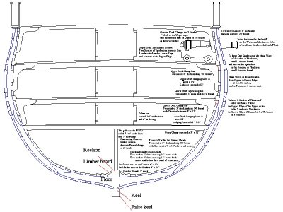

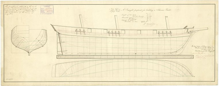

Below I post the sections. The only datum is the keel and the waterlines.
thanks to Dean, Allan teal for your continued support and guidance…..SS

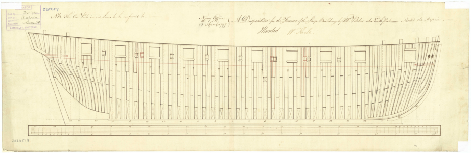

Just a quick question on ZAZ6157 above. The red line on the elevation, is the top of the deadwood as the mast steps are shown baring down on this.
If this is correct I have the rabbet line (at least from the bow to the midships frames as they raise to the stern as well as the deadwood.

The Body Plan is in post #25. Use it to determine the bearding line.
If you make the keel width also be the deadwood thickness. This would be my choice. No hydrodynamic factor in the upper -needs substance for the frame heels - deadwood.
Extend the outside line on the keel (at the deadflat) on the plan. Where this line crosses the frame line is the bottom of the frame- the bearding line. It is deadwood from there to the keel. The adz-work needed to get the narrowing of the planking run in the skeg area comes out of the deadwood.

I have laid down the keel (again) and the deadwood is keel width and follows the red profile on ZAZ6157. Your reply/instruction…. Project the side of the keel upwards and parallel to the centreline. Where this line crosses the frame profile on the section plan#25 is where the frame taper merges with the deadwood and this is the bearding line.
The bearding line therefore rises from the midships frames that are directly on the keel to higher positions as we approach the bow and stern frames.

Yup. You got it.
That line at the midship station - the deadflat - is the top of the rabbet.
i use that as my baseline.
I am always amazed at now deep is the cut into the deadwood -the taper - both fore and aft as shown in the Body Plan.

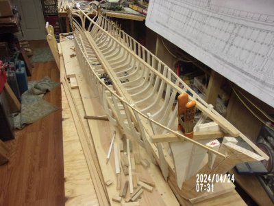

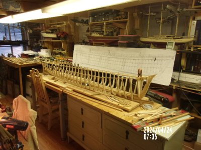

Read my build under Great Republic at 1;48 scale by Norgale. I have been building a model like yours and I've run into many of the same problems you are or will be dealing with. I don't agree with some people here as to the material to use and like the width of the planks and the length. These are two major things that ou will have to decide on your own as they and other solutions work fine. I'll be happy to discuss my experiences with you any time. Pete (Norgale)
View attachment 548279An awesome workshop Pete! I wish I had that much room to work in! Magic Mike
