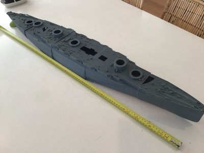

Hello friends,

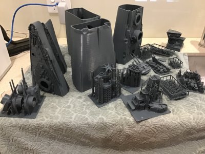

I have just taken delivery of my latest purchase, a 3D printed resin kit of the Japanese battlecruiser Fuso (circa 1944).
I’m currently researching the ship and not sure whether she was a battlecruiser or a dreadnought battleship. Please chime in with a comment if you can clarify this for me.
By the size of the ship, I would assume she is in the super dreadnought class of ships.

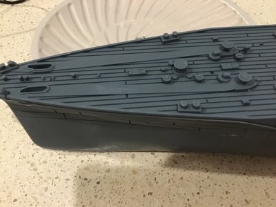

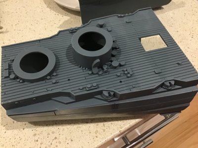

Today I have started separating the pieces from the 3D printed cages that contain the parts and washing them with warm soapy water and scrubbing with an old toothbrush.
You can see it’s glaringly obvious the deck planking is rather ugly and over exaggerated . I will rectify this with some generic timber decking in 1/200 scale.
Other than that, my first impression is it looks good to me.
she is a battleship as a battlecruiser would have been faster. http://combinedfleet.com/ships/fuso
besides fixing the decks, you will also have to do something about the grooves representing hull plates as in that scale the hull hull would be smooth as would the decks be.

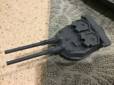

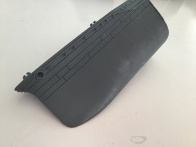

Question, I agree with you about the heavy panel lines in the hull, and intend to fill them in with putty. But I was wondering if it’s accurate for the portholes to be protruding from the hull like the photo attached ? In addition, would the portholes be brass coloured or grey painted ?

Bryian, how thick are those port holes & does the Fuso email i sent you show any port holes as i think they should be either almost flush or they might be steel plated over on the hull like the Americans did after Pearl Harbor?

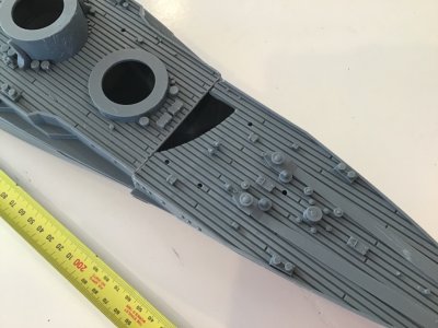

how thick of material can that cutter cut thru & how thick is the deck?
according to the Japanese Combined Fleet & math, your model should be 41.88"/1063.572mm long. http://combinedfleet.com/ships/fuso

the portholes protrude 2mm out from the hull, and it doesn't look correct to me. Anyway, I will enjoy modifying the model to truly represent the real ship.
re-read my last post as i added more info.
are the holes horizontal or slightly angled downward depending on the hull shape?
at 2mm, in real life, that would be 15.748"/399.9992mm, i would do it flush.
