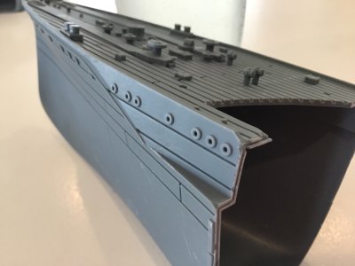

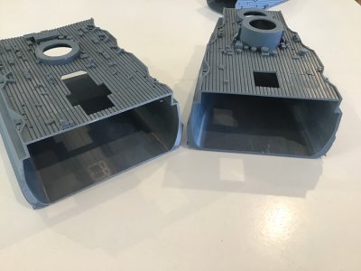

Here’s another issue. The segmented hull pieces are just butt glued together and this could cause alignment issues. My previous experience with the pink 3D kits is that the hull parts were easy to insert with a telescopic action of sliding together ( if you follow what I’m trying to say)
Yeah, that isn't the best way to design those joints : ( Maybe you could glue in some Popsicle sticks to help them go together straight-ish?

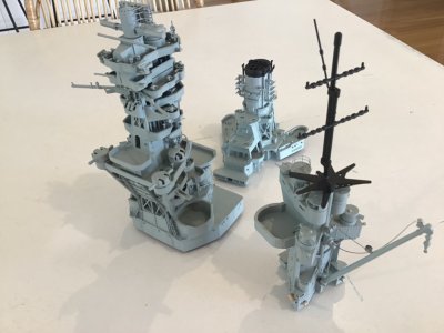

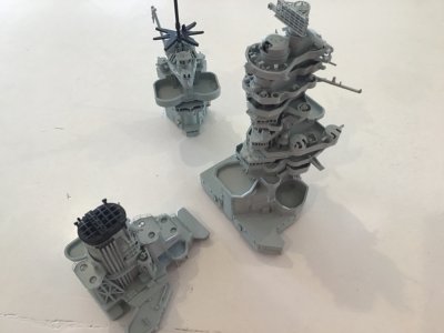

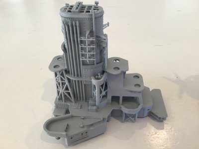

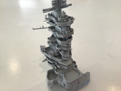

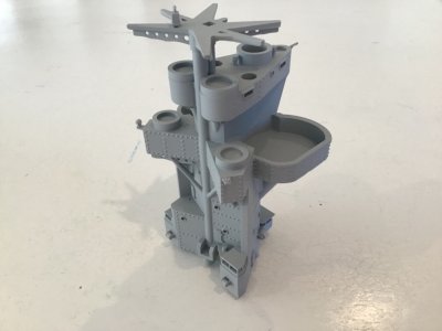

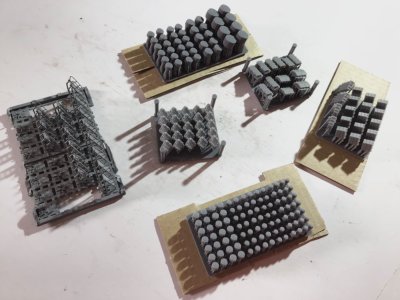

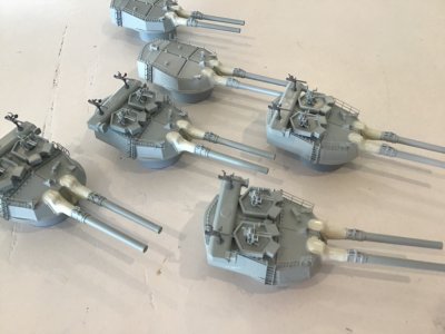

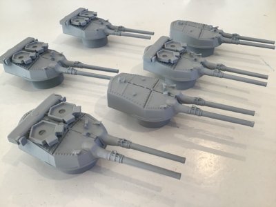

Been at my hobby bench this week and working on the model. I have cleaned up and assembled the superstructure and turrets. The quality of the 3d printed parts are superb, showing all fine details including rivets.
I have applied a grey plastic primer to the pieces so I can see if any fine sanding or filler is required. Here’s a few photos of some assemblies in grey primer.
Despite the imperfections and inaccuracies, I think this model has a good basis for adding my own scratch building modifications.

are you going to add some (brass?) square rods inside to strengthen the construction in it's hole length? So the danger of breaking the brittle resine may go away.
To be honest I am shocked to see an US $500 model being detailled that bulky in it's hull. The rest seams to come in an decent quality - looking foreward your progress.

Hi Chris, yes I used popsicle sticks and a 2 part epoxy glue to join the hull sections together.

I have achieved quite a lot this week. I managed to glue the hull sections together with a strong 2 pack epoxy glue and utilised popsicle sticks to ensure the sections slid into each other without issues.
I then used a 2 part filler for filling the joins in the hull and after sanding, I sprayed a grey plastic primer base coat.
I then removed almost all the deck fittings with my new ultrasonic knife and blade filled the deck smooth with a 2 part automotive filler. Its my intention to laminate a timber deck over the top in the correct scale. I have sprayed the hull anti fouling red, but the upper sections of the hull above the waterline is still in primer.
When I removed the deck fittings, some of the pieces broke apart, so I have purchased replacement fittings from MicroMark.
