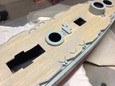

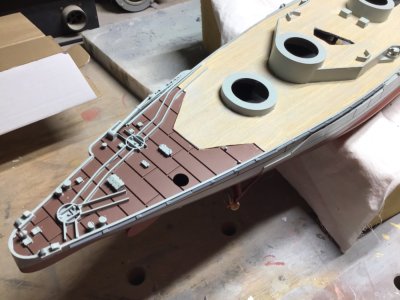

Hi there,
thought I would grab a minute to update my build log. I have spent many days filling over the deck with a 2 part epoxy filler to get rid of the inaccurate 3D printed deck planking . After sanding and smoothing everything out, I applied a grey primer coat to seal everything down.
I then planked over the surface with a generic 1/200 scale self adhesive timber deck and stained the wood in a grey wood stain. I was wanting the weathered appearance for the deck.
Here’s a few photos of my deck after the first coat of stain. I’m planning a second coat mixed with clear satin polyurethane varnish.
View attachment 562044View attachment 562045View attachment 562046
Decking looks good mate, but what's with the 'tiles' on the quarterdeck? They seem to have overly large gaps between them. I'm not familiar with the ship, so that may just be how it looked?
