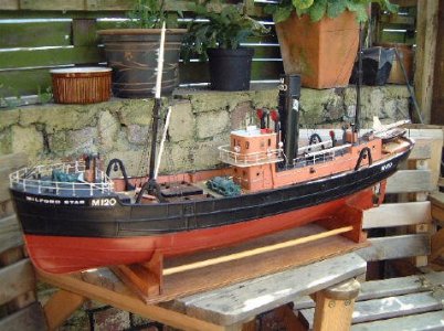

This time I've gone for Caldercrafts Milford Star, there's Trawlers going past me
front window every day so decided to get a model of one.
Looking for advice on Motor, Speed Controller, Radio Gear and Servo's ETC

Welcome back Murph. To power that particular model I would recommend a 550 size Mabuchi or a Pittman gear head (10:1 ratio) motor with corresponding ESC, and Futaba or Spectrum radio equipment. This is what I use on some of my larger models with good results. In my experience you want a good strong motor with well matched working prop. Don't make the mistake of putting super high speed motor with racing prop. You should be going for power and scale speed, not equipment that is trying to put your displacement hull up on plane.
