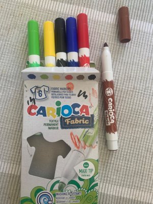

Another possibilty is to use fabric markers.I am using them since 2 years to color small areas ,parts or spots without using masking tapes.
They can also be used for drawing symbols on the sails, Rubbing and Light fastness are good.
Applying a varnish on allready marked or dyed area is also possible without changing the main color
