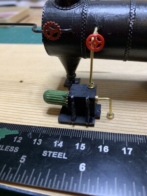

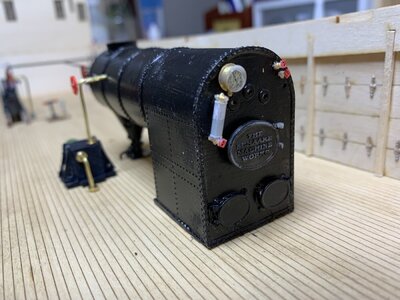

I assembled the paddle wheel, rudder mechanism and various other supporting struts. This was fairly straightforward, but inserting the Pitman arms into the engine was a bit troublesome. It is almost impossible to see what you are doing - you have to position the arms through a narrow slot. In the end I positioned it as best I could. It doesn't really matter if you attach it properly, since you can't see that far inside the engine room. The important thing is to connect the arms to the Paddle wheel, and this was not difficult. I also worked on various bits and pieces, installing the fire buckets, axes, etc.. I decided not to put the axes on the front of the wheelhouse, as in the original ship, but added an extra decal with the ship's name instead. I thought it looked better. I also tested the lights and was happy with the result. The only thing left to do is install the second lifeboat. I am missing a few pulleys for the davits and am waiting for them to be delivered...hopefully soon. Then, the final act is to put together the base.

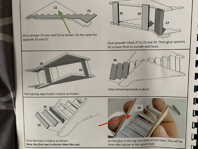

This is the beginning of my build log for the CR Lamb, an early 20th century sternwheeler. I found this kit thanks to a fellow modeller. Inter-Action is a Canadian-based hobby supplier that seems to be focussed on train scenery and diorama items. This is their only ship kit (as far as I know). I was very impressed when I opened the box. The materials seem first-rate in quality and there are 2 cerlox bound binders with detailed descriptions, photos and illustrations.This is the most detailed and comprehensive set of build instructions I have seen in a kit - a sample of a a few pages is included below
