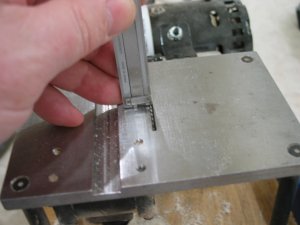

You'll need a blade with a kerf of .0625. You'll also need a small block of wood, preferably a hard wood, that is the thickness of your grating and slightly larger than the largest grating you want to make. You'll need a second block of wood about 1/4" to 1/2" thick and larger than your largest grating.
The first step is to set the height of the blade so that it will cut grooves in the block of wood that are about 1/2 the total thickness of the grating. I use a pair of calipers set to that height and use them to set the height of the blade as shown in this photo.

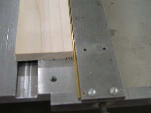

Next, set your fence to be .0625" from the inside edge of the blade. You will be making cuts across the block of wood you have that is the thickness of the grating. Each time you run the block of wood across the blade, after making the cut, you will set the block of wood down onto your blade, loosen your fence and place a spacer between the fence and the edge of the block of wood as shown in this photo. Notice that I'm cutting with the grain of the wood. For this demonstration, I'm using poplar but maple would work and the most preferable wood is boxwood.
You can buy these brass spacers from Micro Mark. This spacer is exactly .0625" in width.
Now remove the spacer and make another cut across the block of wood by pressing it up against the fence as you run it across the blade. Repeat this process until you've cut grooves across the entire width of the block of wood. You'll end up with a block of wood that looks like this.
