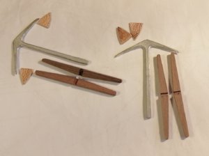

I had the same problem with flukes as one pair of Caldercraft anchors I ordered came without flukes.
(The anchor blanks weren't drilled nor did they include any wire/rod for making the ring as the other pair of larger Caldercraft anchors had. An anchor isn't an anchor without flukes and a ring for attaching to the cable!)

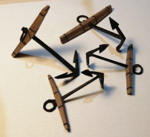

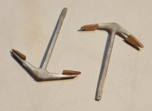

I cut some Beech very thin and made a ply with that then cut out the shape of the flukes. They were glued on using a little epoxy resin.
Here's what they looked like >
And fitted >
And finished, along with the two "proper" anchors that came with all the parts >
Before fitting the anchor stocks, the white metal and the wooden flukes were just painted with matt black acrylic paint.

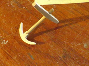

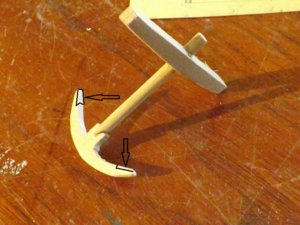

I'm determined to make them myself rather than buy them and I'd better clarify my question. It's not the actual flukes that are problematic, its the curved shaft they are attached to. Try as I may I cannot get the curve consistently correct, they just don't look right, or like metal.
Hi Steve,

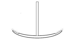

Looking at the photo of your anchor it looks pretty much like the curve of European anchors of the 18th century (as opposed to the straighter, more angular anchors of English ships of the same period).
I think you might be able to adapt that curve to accept the flukes by carefully filing a flat on the insides near both ends of the curves as I've tried to indicate in the photo and drawing below >>>
Thanks Jim. I've just realised - photographs do lie!!!!. The pic looks so much better than the real mk VI lol.

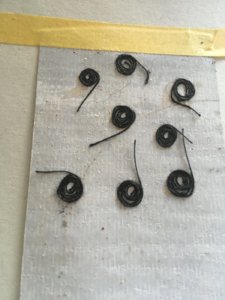

And who knew making rope coils with sticky back tape could be so strangely satisfying!
