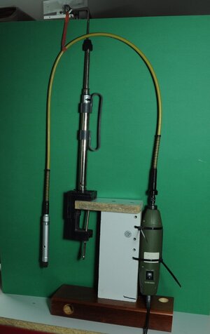

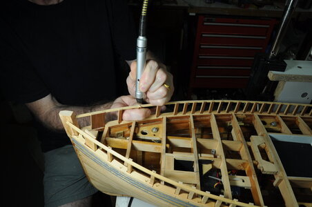

I had an idea to cobble together a Proxxon or Dremel drill with a flexible shaft and a foot switch. While enabling me to easily move the assembly around to make drilling small holes easier. I have trouble drilling small holes without "enlarging" them accidently, I did find a foot switch helps a lot but for me at least still not as good as I would like. I am sure someone else has done something like this although I haven't seen one.
All I did was screw a few pieces of scrap wood together, I have used it over a few days so far and find it works quite well and thought I would share the idea, in a large part the foot switch is key.
I think the photo is self explanatory.
Cheers,
Stephen.
this is a good idea, because hanging the Proxxon on the hook, the flex. shaft will go hang downwards. Now it is going up and give you more freedom to use it. I did this by mount the Proxxon in the drill stand and turn it 90 degrees to hold him flat.

Can you be specific about the flexible shaft source? I have a Harbor Freight set with a foot switch and the flex-shaft is not as flexible as I would like. Thanks!
Hi J,
The flexible shaft is a Proxxon and is quite flexible and is available with collets or keyless chuck.
Proxxon 28620 Flexishaft Micromot 110/ P with 6 Micromot Collets https://www.amazon.com.au/Proxxon-28620-Flexishaft-Micromot-Collets/dp/B000S5KMPK
Proxxon 28622 Tree Flexible Micromot 110/Bf With Keyless Chuck From 0,3
Cheers,
Stephen.
