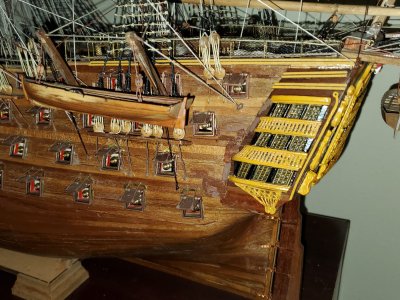

Here is another image. As I mentioned earlier a lot of the green powder is under the copper plate. Some of the worst pieces I removed, cleaned and glued back on.
I spent two hours just in this side to get it as it is.
I gather, if I brush the enamel lacquer on now. It will stop any further degradation?
If so. I’m going to go with this. I like how it looks now.

Graham’s suggestion to use lacquer is not a bad one, but honestly I don’t see any reason a spray acrylic wouldn’t work. Unless you live in a humid, salt-air environment (which I am led to understand is not common in the land of Aus) then I don’t think you need worry a whole lot about additional oxidation on copper. If anything, I think it would tend to even out the patina.
I prefer acrylic finishes over lacquer because of drying time and clean up. Might not be the right thing for furniture that gets a lot of wear and tear, but works fine for models.

Krylon is available down under and they have a wide variety of clear spray (rattle can) finishes in gloss, satin or matte. Most any of them would work, but I would stay away from the artist's fixative - it will wipe off. You should be able to find them at your local home center or at The Artist Warehouse, although it will probably be more expensive at art stores.

i live in a high humidity area in Australia. Humidity at the moment up around %80. Uptown 95%
I've never used it, but I don't see why not. It should theoretically "freeze" the plating the way it is, which is what you want, right?
Yes that’s the goal. Basically keep it the way it is. I can not find anything else to use where I live. The only thing. I believe it might be a gloss Finnish.
I may have no other option but to use this. Where I live is a harsh environment, High humidity and close to the coast.
