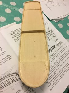

I just re-started my attempt on the Sultana. I have sanded the hull and carved the bulwarks. I probably should have taken them down to deck level. Some portions are thicker than others. I want to make a cradle but unsure how shape it. Also, I am confused about transom. Is it shaped for piece of wood in kit? I have attached a pix.
