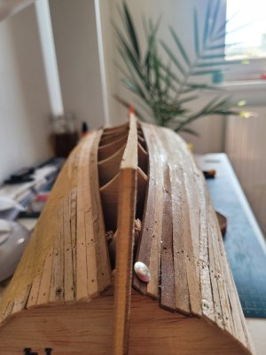

This is the best result I got without damaging any plankings. I'll had to cut the ship in half both side just like the commenter said by the start of this thread. I feel sorry for this ship. The problem is with the bulkheads, they have been cut very poorly and assymetric. I don't wanted to Invest so much time to start the whole ship from zero. And the with the cost of the new materials I can purchase a new Kit and start another without any headache. The kit comes with some great carvings but the base is trash. In that case I have 2 option, I can dump the whole thing, and trash it. Or accept this state of the Ship. No idea
Or, third option, fill the bulkheads with solid soft wood, such as balsa.
This will straighten the model as much as possible.

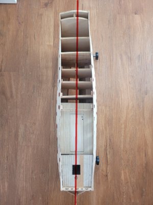

If the frames are assymetrical, cut your losses and start over. This ship isn't worth the effort.
This is the very definition of sunk cost fallacy.

I'm sorry, but I can't imagine how a plank on bulkhead hull with bulkheads that "have been cut very poorly and (are) asymmetric" can ever be planked fairly. Bulkheads define the shape of the hull, and in most POB kits they do that poorly at best. Sometimes encouraging a multitude of futile suggestions, while admirably encouraging, only provides further frustration.
I got a Photo from above. As Dave Stevens said I will never be satisfied at the end when I'll Continue from here. I didn't cared the look when I purchased because it's rare to find any ship models at fairs, and I'll wanted to take a closer look, maybe i'm able to repair. So the most of the commenters said to dump the project and start another. Maybe it will be the best, I feel bad for this ship but I will dump it then. Thank you all!
In this case, a fundamental mistake was made when installing the slats. The quality of keel frames is usually quite poor/often and crooked/. I clamp the keel between two rigid strips, mount the frames, install several planks and when the assembly becomes rigid, remove the fixing strips and continue the planking. The hairdryer allows me to glue and fix the defect if necessary. Judging by the photo, it's already firewood!
