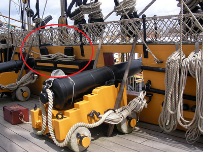

Staghorn on HMS Victory
Thanks Jim, that makes them a little easier to make. The problem I'm having now is that the Discovery doesn't have much in the way of bulkheads on the quarterdeck and forecastle to attach kevels to.
