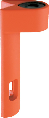

Ah yes that would explain my observation. I know from experience trying to plumb up a post or rod in two directions simultaneously can be a chore. We all could
use one of these gizmos only miniaturized.
