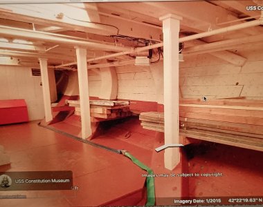

One of the great things about modeling the USS Constitution is that you can use Google Earth street view to walk any of the deck levels. ( Though the orlap deck access is limited to the midship area.)
I find the orlap deck area of the present day ship to be confusing, since part of the deck around the main mast area seems to be cut away, exposing the red-painted hold area.

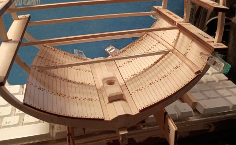

The trouble with trying to modify a kit is that one often has to figure things out on their own.

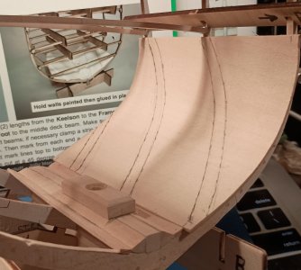

I've been stuck for a couple weeks trying to figure out how to get the proper spacing to simulate planking in the extended hold-orlap area I'm trying to create.

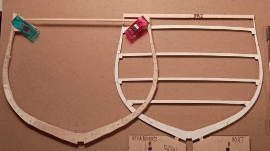

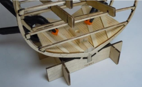

This is what the kit provides

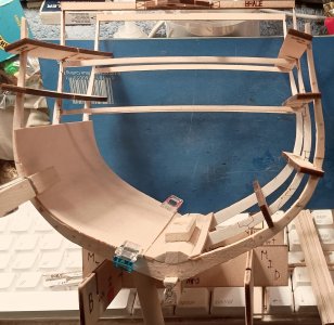

This is what I'm trying to fit in after removing deck beams

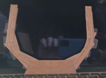

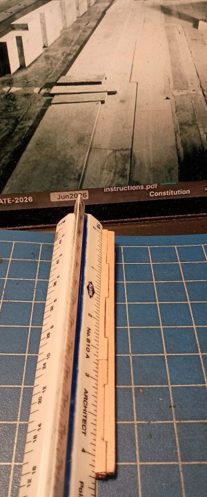

I've been making paper patterns of the planking
I think I've finally got a pattern that's workable so I can move ahead at last.
What a frustrating struggle.

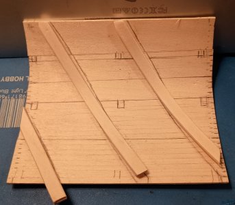

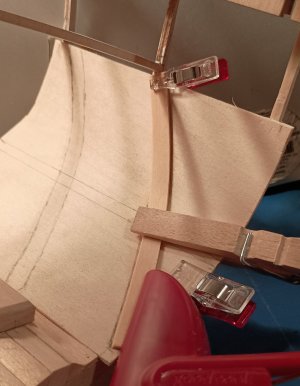

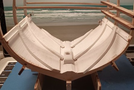

With the port-side hold/orlap custom planking scribed, I'm able to move ahead with installing the bracing the way I want it.

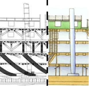

kit instructions
actual ship

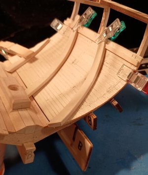

modified model bracing
My braces are twice as thick as the kit braces.They look a lot better than the kit's original thin strips.

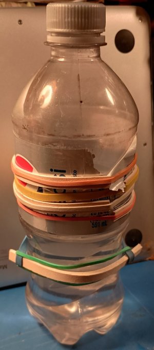

I made the diagonal braces out of pairs of 1/16" x 1/4" basswood strips glued together.
(I suppose 1/8" x 1/4" strips could have been used, but I found it easier to soak and pre-bend the thinner strips before letting them dry, then gluing them together.)
The longer bracing is notched to straddle the shelf plank that the berthing deck beams will rest on.
The extended hold-orlap ceiling does away with a gap that exists in the original kit design.

Custom Hold Planking

Bracing Progress . . . at last
With the port-side hold/orlap custom planking scribed, I'm able to move ahead with installing the bracing the way I want it.kit instructions
actual ship
