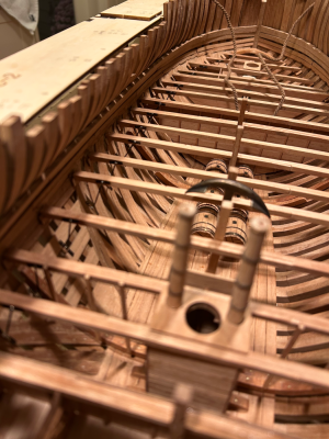

I have been building the frame which sits over the mast well and the bilge pumps.
The mast wedges are CNC cut and are really nice, complete with curved inner surfaces:
The bilge pumps have a wooden body (elm?) with photo etch details, including what looks like a strainer at the bottom:
The mast frame has a small lip on each long side and I chosen to sit it into the beams. The CAF plans suggest there is planking, but that it is somehow different to the rest of the deck. Boudroit shows a similar arrangement. In my mind, this would be consistent with having the deck slightly raised around the mast.

After completing the mast well, I thought it might be a bit of fun to see what the main mast and fore mast looked like:
I shouldn’t be surprised as it’s a CAF kit, but the mast and wedges fitted almost perfectly.
Each day has its own struggles, but overall I think La Renommee is looking OK (touch wood).

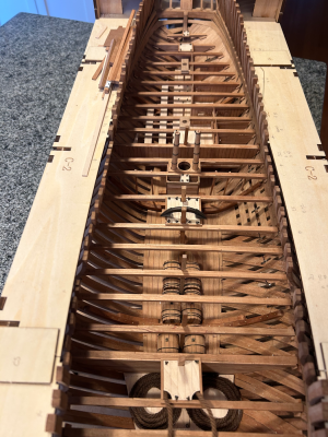

And here is the rest of the framing for the lower deck:
As you can see, the spare anchor is lashed to a post. It was a nice casting and needed only a little cleaning up. The shank had a slight curve, but that was easily fixed as well.
The anchor cables are also in place:
The cable in the kit was quite nice, so decided to use it. Each one is about 1.2 meters long which seems like a lot, but it’s only about a quarter as long as would actually be needed in scale as cables on French ships were about 195 meters long!! I had to use quite a lot of white glue mixed with water to get the cables into the coils. I then mounted them on a base of plastic card so they hopefully won’t unravel. There still a lot of building left to do and no way of repairing the coil after the lower deck is in place.

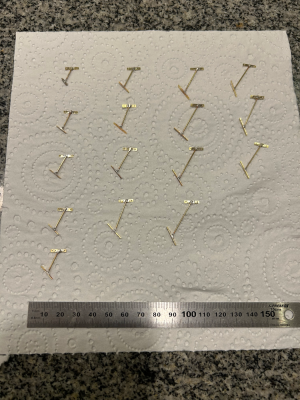

Another detail before I can start planking the lower deck is the rest of the metal knees for the beams.
I’m a little surprised they fitted as well as they did, given what was involved. A few needed a minor tweak to get the foot to sit on the hull, but nothing major.
I think they’ll be visible in the hold when I cut away frames on the starboard side.
Kind regards

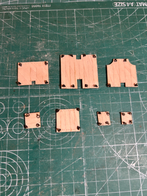

I have made a start on the hatches in the lower deck.
The largest hatch has cutouts for a post and another for the spare anchor. I think it actually was split in two in practice. The one to its right has openings for another post and the anchor cables.
All the wooden pieces are laser cut. As you can see, there are two types of rings, round for smaller hatches and triangular for larger hatches. It was quite a fiddle getting all the details in place and I think they look OK, although the iron work on the three smallest hatches may be a little too much. It’s hard to be objective when you’re been staring at something so small for so long.
Planking the lower deck could be difficult with all of these, plus three masts, sitting on the centre line.
