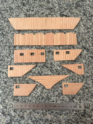

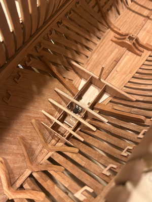

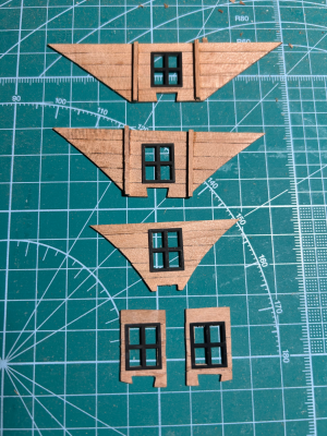

The next step is the partitions for the powder magazine and powder bag stores. There’s some with photo etched windows:
I’ve not used Brass Black much before, but think it was easy to use and leaves a very nice finish. I don’t know why I didn’t use it on Le Coureur…

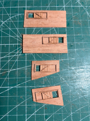

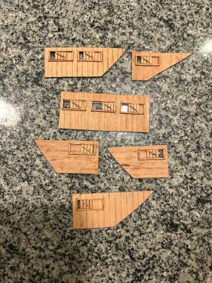

Others have shutters:
The shutters slide. I had to cut tiny bevels on the frames and panels to do this. It’s not mentioned in the instructions, but there were similar shutters on my Le Coureur which were supposed to work, although I think I made them with thicker pieces of timber back then. After all that however, I might fix the panels in place with glue, because if they ever come loose I’ve got no chance of putting them back.
They’re all 1 mm thick strips and feel quite fragile. There are plywood templates in the kit and I’ll use those for an initial fit as they’re more robust.

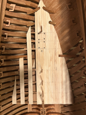

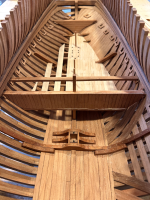

Beautiful workHere are the partitions in place:
I wasn’t sure how all this was going to work, but once I decided to install the forward most partition first and work backwards, it all went in without too much trouble. I am pretty happy with the result.
The photo etched lamp is a nice touch as well.

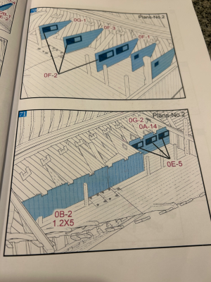

Thanks for the response and for sharing your thoughts, Tom. Much appreciated.Paul, I agree that there’s absolutely no reason why the partitions couldn’t be built from plain strips. The kit has full size plans for all the partitions as well as plywood templates, so you have all the necessary information. The kit also seems to enough 1.2 x 5 mm strips to build the partitions. Some of the laser cut parts are different widths - e.g. 4 mm boards - but I don’t think that is an issue and the 5mm strips would work just as well.
For what it’s worth I don’t think removing the charring is a big deal. I use a sanding pen with 240 grit paper so I only take off the bare minimum and only takes a short while. For across the grain, I tend to use a knife to slice it off. It can be fiddly on small and thin parts, but generally there’s a method to deal with it (including just making the part yourself). In a sense, “char” is a bit of a misnomer. It’s not powdery and certainly doesn’t rub off on your fingers.

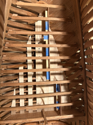

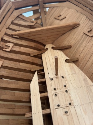

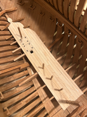

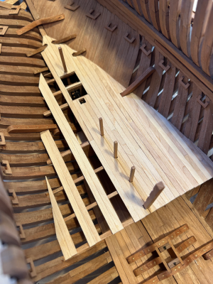

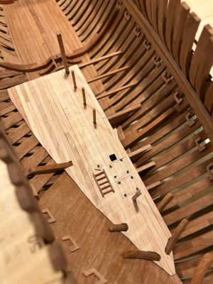

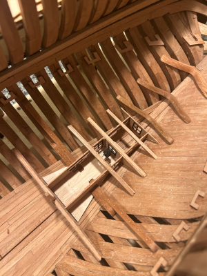

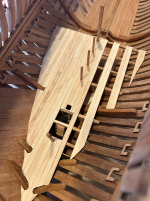

I’ve been doing some nailing with birch toothpicks in preparation for installing the partitions:
Some of the nails will be covered by the partitions, but I thought it was just easier to go ahead and do all the beams.

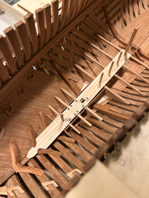

Here is the start of the partitions:
