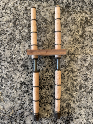

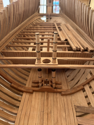

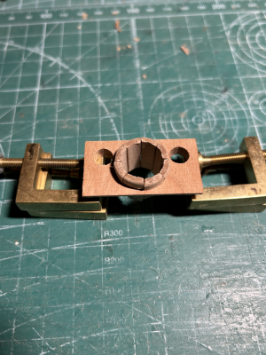

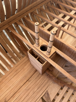

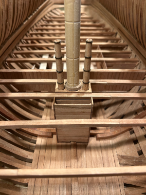

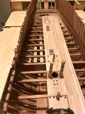

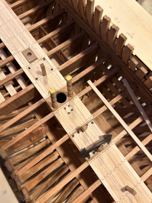

I have been building the frame which sits over the mast well and the bilge pumps.
The mast wedges are CNC cut and are really nice, complete with curved inner surfaces:
The bilge pumps have a wooden body (elm?) with photo etch details, including what looks like a strainer at the bottom:
The mast frame has a small lip on each long side and I chosen to sit it into the beams. The CAF plans suggest there is planking, but that it is somehow different to the rest of the deck. Boudroit shows a similar arrangement. In my mind, this would be consistent with having the deck slightly raised around the mast.

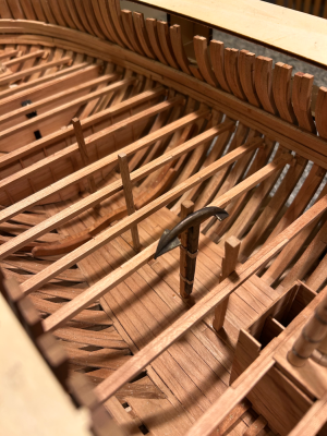

Beautiful work! Love it!And here is the rest of the framing for the lower deck:

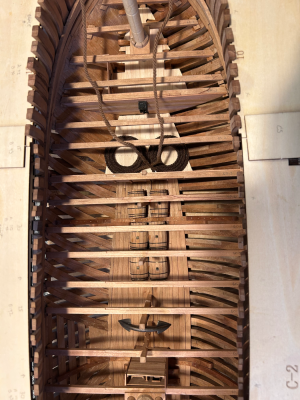

As you can see, the spare anchor is lashed to a post. It was a nice casting and needed only a little cleaning up. The shank had a slight curve, but that was easily fixed as well.

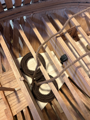

The anchor cables are also in place:
The cable in the kit was quite nice, so decided to use it. Each one is about 1.2 meters long which seems like a lot, but it’s only about a quarter as long as would actually be needed in scale as cables on French ships were about 195 meters long!! I had to use quite a lot of white glue mixed with water to get the cables into the coils. I then mounted them on a base of plastic card so they hopefully won’t unravel. There still a lot of building left to do and no way of repairing the coil after the lower deck is in place.

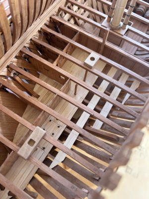

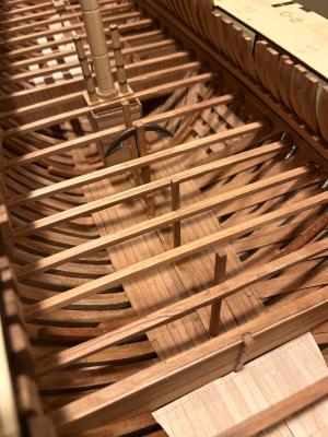

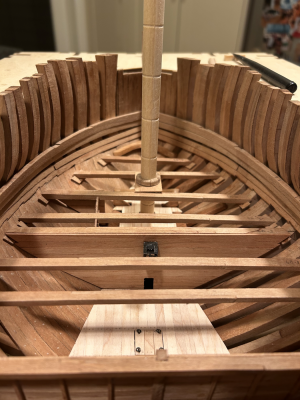

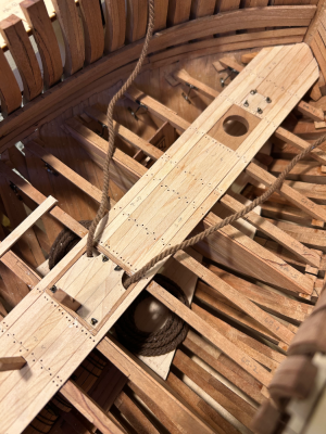

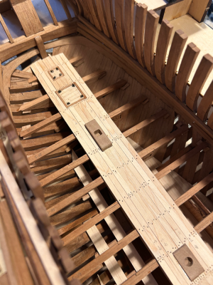

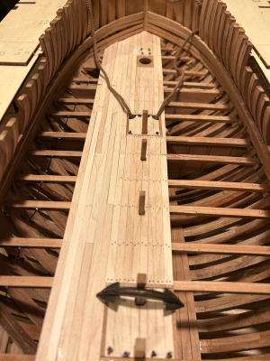

Well done!!Finally onto the lower deck itself. I thought I was there about a week ago, but things just kept getting in the way.
Here is the first bit down the centre:
Nothing is fixed in place as I’ll do the trunnels off the ship (or at least the ones around the main mast and spare anchor).
I’m just going to run the planks fore and aft and won’t be trying anything fancy like tapering and nibbing. In his monograph, Boudroit does show some of this, but for the most part there’s very little. I can’t imagine much attention was paid to this part of the ship as a good portion of it was used for storage and the like. There also no caulking because I don’t think this deck would get wet very often.

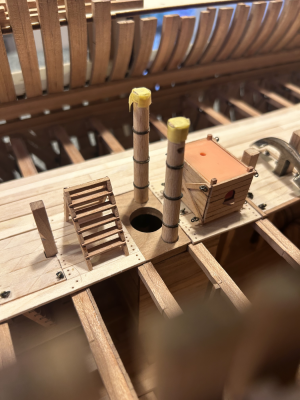

One thing I almost forgot were the ladders for the hatches:
Again, lovely little details. Each ladder is different and I didn’t need to trim to fit so the distance between deck and beam must be about right.
