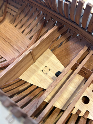

Here is the deck for the bosun’s stores:
I glued the middle eight planks together off the ship in order to cut the opening for the fore mast. I then added pairs of planks to each side until finished and then put the entire deck in place. The braces and mast step made for a complicated deck shape, but once I’d settled on this method, things went reasonably smoothly. There’s no missing planks in this deck as this is the lowest level and there is little detail underneath.
I roughly cut the opening for the foremast with a series of holes with a small drill bit before finishing it by hand with a knife. There’s only a few millimetres between the deck and mast step, so I can see the foremast will fit without any problems.
As with the stern decking, I didn’t bevel the edges planks where they meet the ceiling planking.
There’s one final thing I should mention. The deck overhangs the aft most beam by 1.5 mm to accommodate uprights notched into it. I discovered this almost by accident when I just looking at the plans. When I looked closer, it was shown a few steps further on in the instructions.

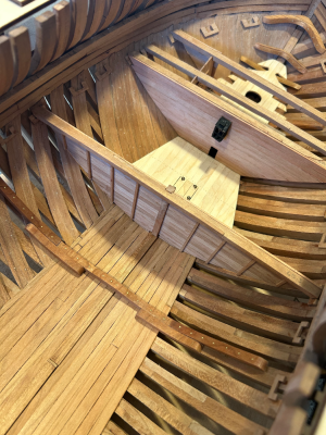

The bulkhead which separates the cable tier from the area for the water stores:
I found this difficult. Some of it was self-inflicted when I managed to cut the notch in the cable tier in the wrong place and had to replace the planks. It also wasn’t clear to me that the upright post physically bisected the bulkhead. The template for the bulkhead is one piece. Again the answer was in one view in the plans which shows the post down the middle of the bulkhead with planking on either side. Once I had made this leap in understanding, things proceeded more smoothly. In particular, the fit of the bulkhead against the ceiling planking improved considerably.
I am reasonably pleased with the result. There’s a lot going on in this area, particularly where the beam, cable tier, bulkhead and upright meet. The templates for positioning the beams certainly have been valuable as there are consequences if their the beams are even a little out.

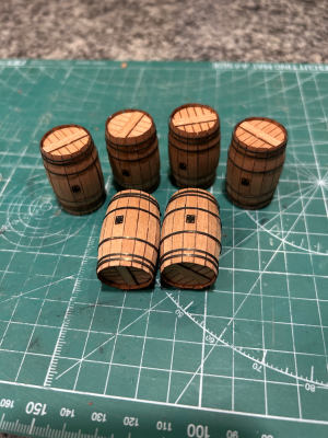

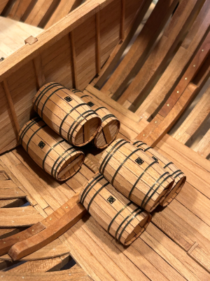

Today, I had a go at making some barrels for the hold:
They are a CAF kit (what else?) and have a plywood skeleton with a veneer outer. The hoops are brass photo etch and are quite curved on the sprue so they form a slightly conical shape when joined into a circle.
I remember I really struggled to get a good result with the barrels on Le Coureur. This time, things went much better in terms of process as I learnt from my mistakes the previous time, but still lots of work to get a result I was happy with.
I’m not going to do more barrels. I just want to hint that the hold contained barrels, but not fill it up as it would have been when at sea.
Kind regards
