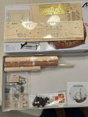

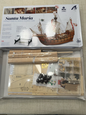

Finally, I get to open the Santa María kit from Artesanía Latina after completing La Niña and La Pinta. This feels like the final step in building the fleet of Christopher Columbus, and I’m excited to get started. I’ve learned a lot from my previous builds—including all mistakes—so I’m hoping my skills keep improving. This time, I want to be more patient, take things slower, and avoid the errors I made before.
Let’s see how it goes.
To get started, I went through the model manual—looks like our friends at Artesanía Latina had decided to favor pictures and logos over written instructions.....Let’s see if these pictures really are worth more than a thousand words this time !!

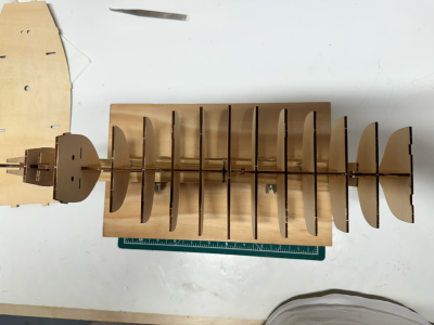

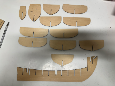

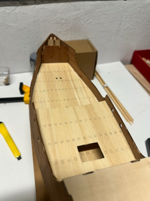

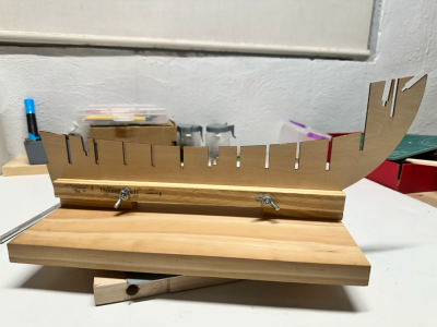

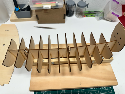

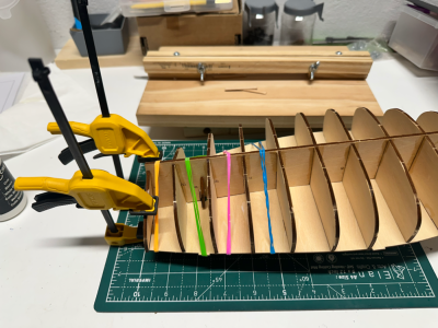

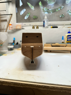

So far, I’ve installed the frames onto the keel and fitted the main deck.
tempImageeUtMh0.pngtempImagelISn8u.pngtempImagevvOqOt.pngtempImage2jbooX.pngtempImageOMvl8a.pngtempImageT3mCdK.png

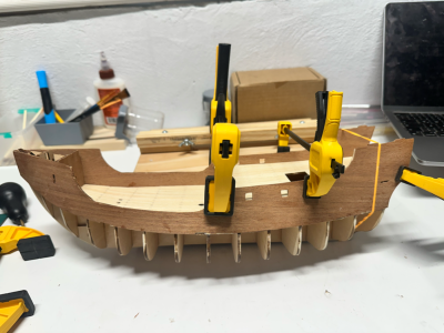

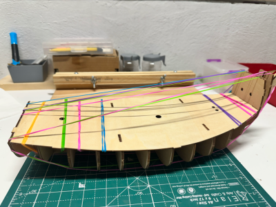

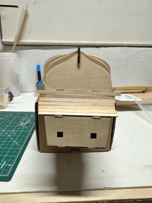

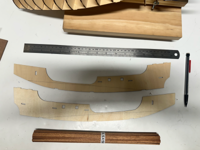

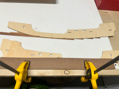

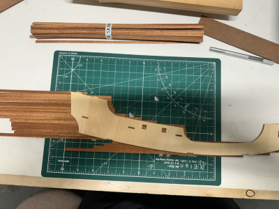

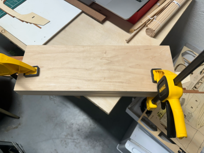

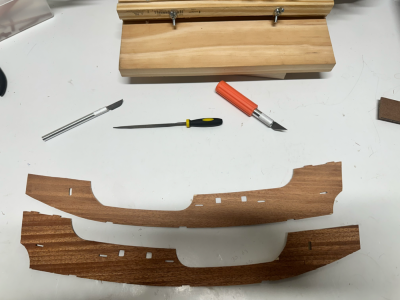

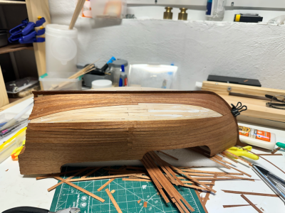

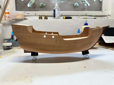

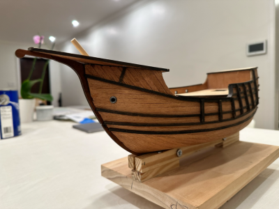

Installed the planks on the lateral frames as shown in the pictures, applying a bit of pressure to make sure everything sits right before cutting.
tempImageqEYQNJ.pngtempImageRPnTPT.pngtempImageSzUMhP.pngtempImagehij8qM.pngtempImagei6Kz0q.pngtempImagedbnR87.pngtempImageBBU9v5.png

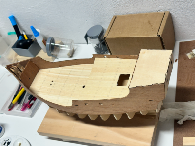

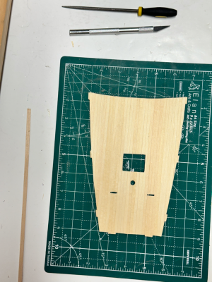

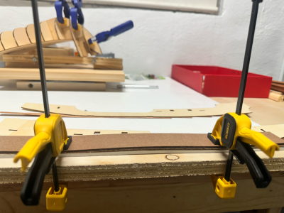

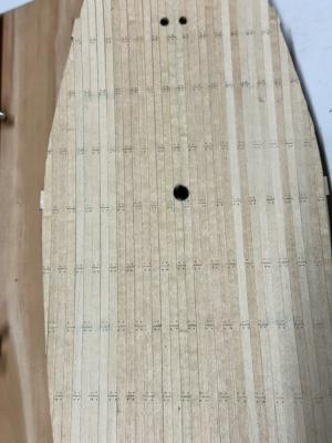

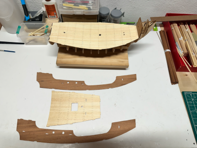

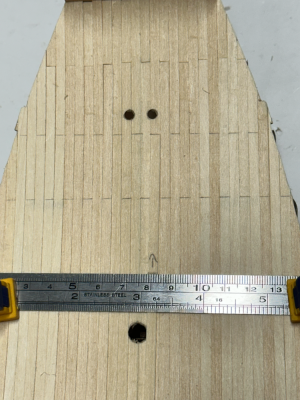

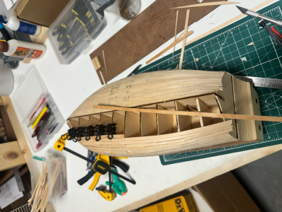

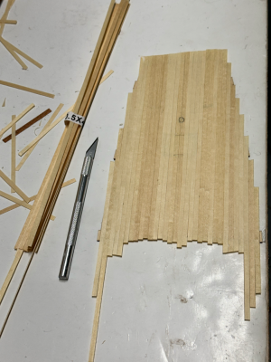

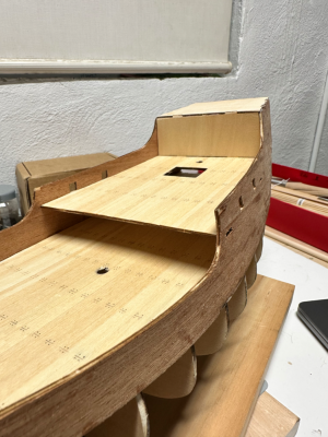

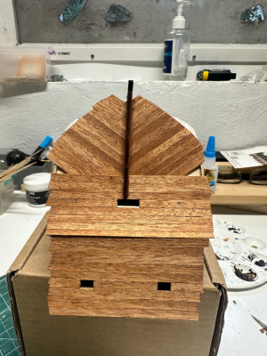

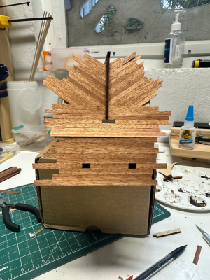

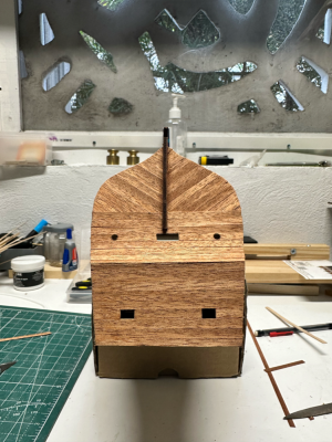

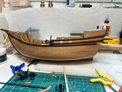

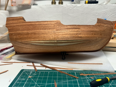

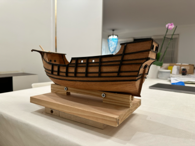

Today’s progress: the main deck is in place and planked , and the aftcastle planking is complete and ready to be installed.
tempImageQljylI.pngtempImagedjPVyG.pngtempImage7lVBIf.pngtempImage6lncKZ.pngtempImageZdnayU.pngtempImageanNR7c.png

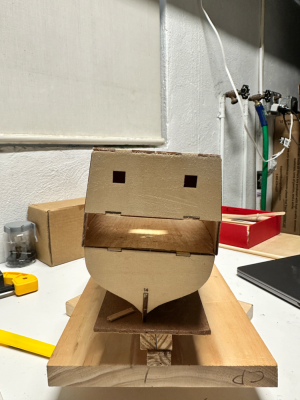

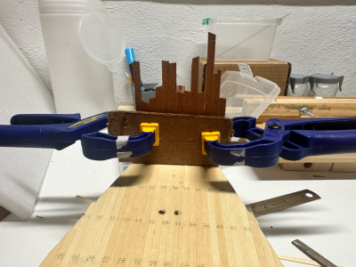

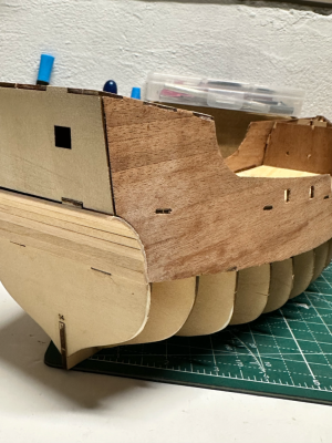

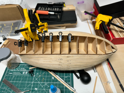

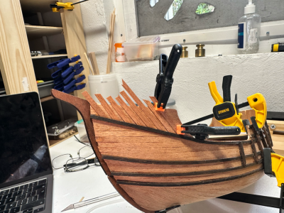

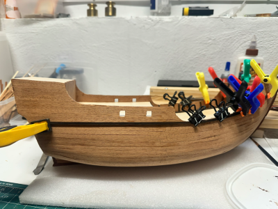

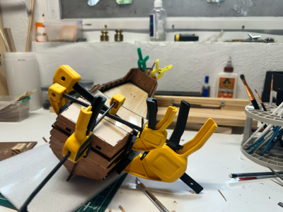

Installing the side sections proved challenging because I wasn’t using the correct adhesive—likely a novice mistake. After switching to an instant-dry glue, the issue was resolved, and progress is continuing.
tempImagetiOc6R.pngtempImagejQCrvl.pngtempImage47xJ9Y.pngtempImageSpo3mn.pngtempImageN0gbKX.pngtempImageH5ZPae.pngtempImagegdYYNn.pngtempImageTsVONn.png

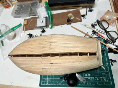

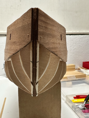

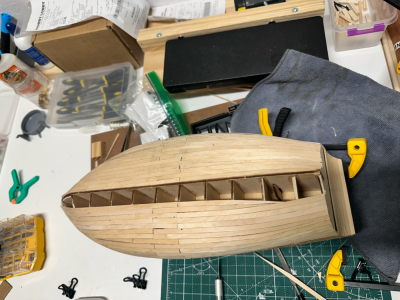

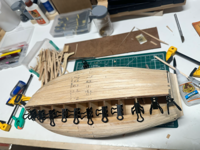

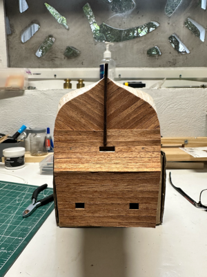

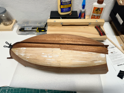

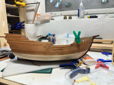

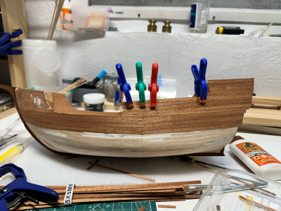

Finished the half hull planking on the port side. I decided not to go the usual route of working both sides at the same time—figured I’d focus on one side and get it right before moving on. It feels easier to keep everything lined up and looking clean this way. Let’s see if that theory holds up…
tempImagekqUnco.pngtempImagehVyanp.pngtempImageyqs8LT.pngtempImagefP1Ou7.pngtempImagelrCzoX.pngtempImageLdlAdj.png

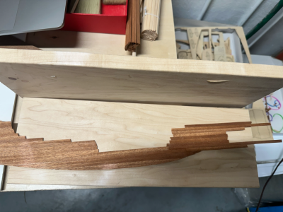

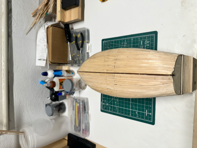

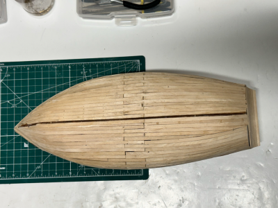

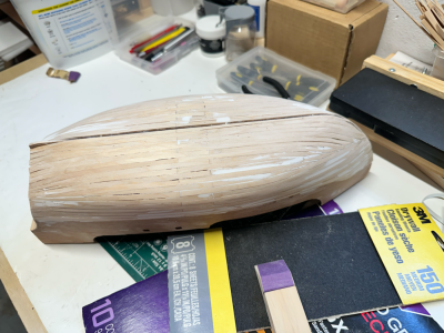

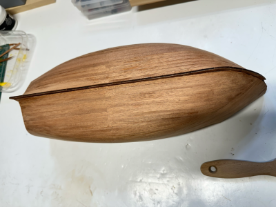

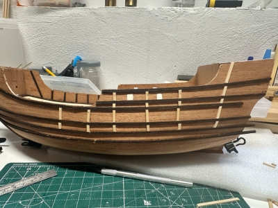

Finally finished the first hull plank! The mirror theory didn’t turn out to be exactly right, but honestly it looks pretty good to me. With a bit of putty and sanding, the imperfections hopefully should barely be noticeable.
tempImageQeVjpT.pngtempImage4FLA3t.pngtempImageFv6QlM.pngtempImageGKTXyc.pngtempImagedIhl2X.pngtempImagenJAiPn.pngtempImagetbduXg.png

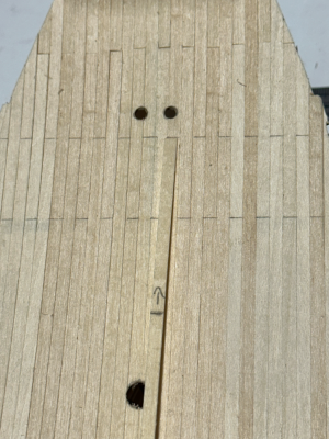

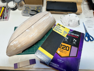

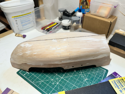

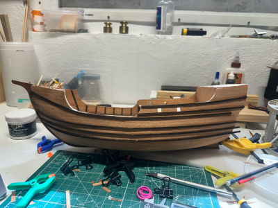

Finally got the first plank sanded using 100, 150, and 220 grit. Added a bit of filler to clean up some imperfections, then smoothed everything out.
Happy with how it’s shaping up so far. On to the second plank.
I just started the second plank, and it’s kind of amazing how you can spend hours working and, by the end of the day, it feels like you haven’t made much progress. But that’s part of the hobby—patience and taking things slowly really matter here.
